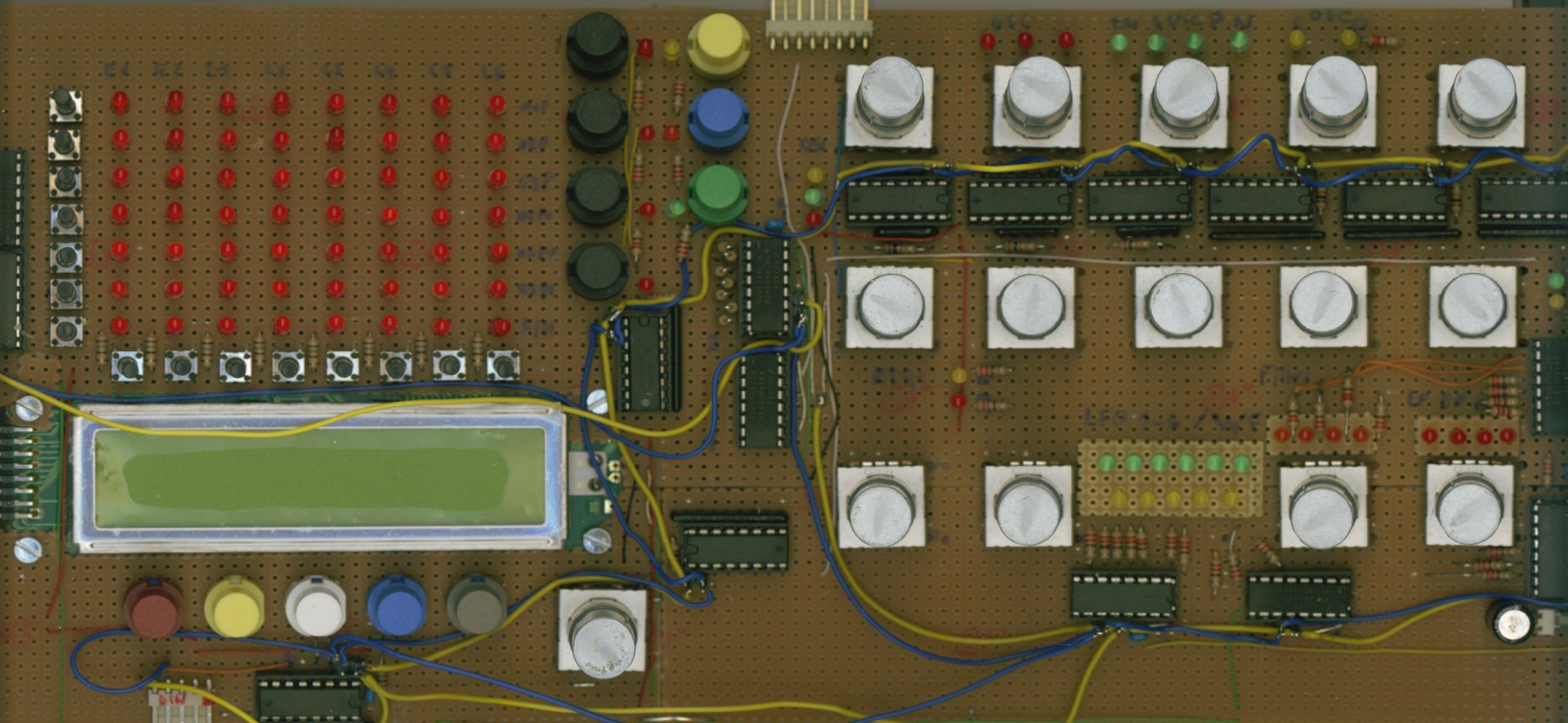

Sorry for the long post! I’ve attached a pic of my panel, so if you are interested…
