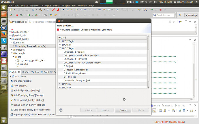

However, I don’t have the option to create a “FreeRTOS project”. I attached a screenshot of the options I see.
Do I have to install any additional software or maybe an older version of the LPCXpresso IDE?

You need to choose an older IDE version, 6.x if i remember correctly
Ok, I will try that. Thanks!
For some reason I remember having this very problem when I tried to load the MIOS into my LPC17 but it was about 9-12 months ago.  Why don’t you try to select the LPC175x-6x -> “C Project” or the “LPCOpen - C Project” and see if you can load the file this way.  The Laptop that I did this with had display problems and was replaced so I don’t have anything to verify what version I did this with.
I made a mistake with the version. You will need 5.x which can be found here: http://www.lpcware.com/lpcxpresso/downloads/older
It worked with version 5.x.
Thanks a lot!
