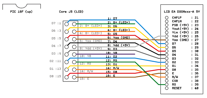

As these modules provide 4-bit and 8-bit modes as well as and SPI-Interface, I’m a bit lost with the connections and what I should do with the Background-Illumination… anyone knows how to connect these? And do I need to connect “V0”? I thought I better try asking before killing my first module :slight_smile:
Any comments welcome!
I attached a drawing I made, to make the connections clearer:

However, I just connected everything as in the schematic above -
and the remaining connections like descibed on page 4 (5 V, 8bit): I connected B+ and B- to the +5V, GND signs in the schematic, but unfortunatly nothing happens, it just stays dark ;(
