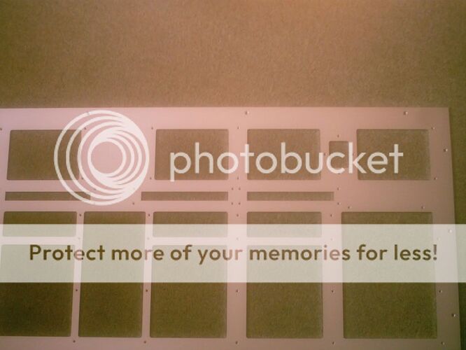

Front panel for the live box:

Who did the drilling? Or do you have your own cnc router for that?
I got the panels cut at Schaeffer - mega $. My strengths are with electronics/programming etc but I’m not very good at the manual things. I figured that with taking 2 large projects on and having a schedule on the live box I would be much better off getting the panels cut professionally as, expensive as they are, it would work out cheaper with cost against time. At the moment I’ve actually got 2 live box front panels - the first one arrived damaged on one corner. Shaeffer asked if I wanted to have some money refunded or have the panel recut - I decided for a recut because with the thing being so expensive and a one off I wanted it to be perfect. I was expecting Schaeefer to pick the other panel up but they haven’t done so yet. If it turns out that they don’t want it back I may have a pre cut panel for sale if anyone is interested (it will have to be the same layout design etc, natch but I can supply a parts list for what it has been cut for). I’ll also have some expanded PVC for sale at some point too if anyone wants it - it’s 3mm thick and I’ve got around 1.5 square metres left (I think - I haven’t measured it yet).
