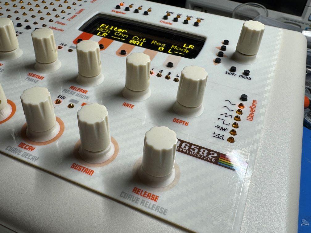

Hey everyone, just wanted to share my latest build since I’m sure there are some 3D printing enthusiasts here like myself.
I bought the parts for an MB6582 about 5 years ago, if you remember Meeblip was selling those 8580 SID chips and I picked up 8 of them, and then put everything into a box in a closet .

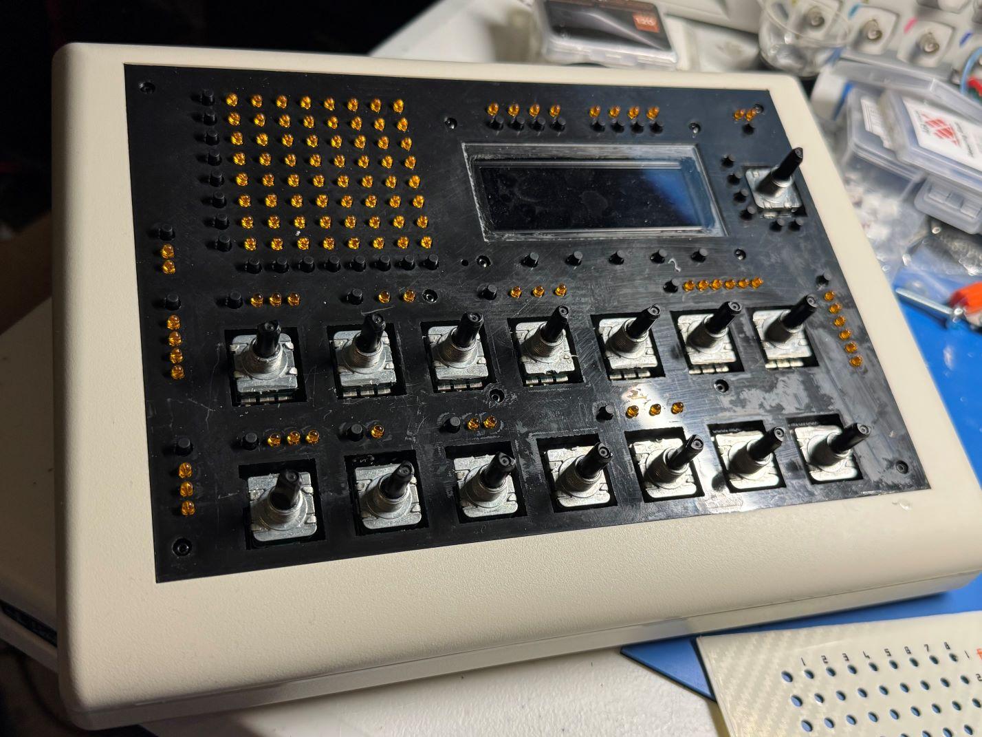

3D printing has come a very long way since the original MB6582 was created by Wilba. I read that the JB Weld solution may or may not be holding up great after all this time.  Also, I wanted to use a Newhaven OLED which is much thinner than the original LCD.  I thought there must be a solution to lower the gap distance so why not create some type of spacer for between the front panel and the PCB?

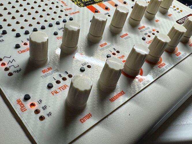

I designed all parts in Fusion360. The PCB screws directly into the spacer using M2.5 nuts/screws and plastic screws. The top of it has a flange that rests in the panel groove for the PT-10.  Total spacer height is 5.7mm which is the height of the base of the encoders. The front panel is another 1.25mm. Everything is printed out of ASA, which is very strong and heat resistant.
I designed the panel graphics in Inkscape and printed on translucent vinyl. I used Davies knobs with small printed skirts to cover up the threads of the encoders since they were exposed. I do not have a vinyl autocutter but I do have an exacto and lots of patience
Overall tried going with a 80s beige computer look. A build plate for my printer created the carbon fiber effect on the panel.
I’m happy to share the 3D files if anyone could use them.

Here are the files.  If someone could post them to the appropriate location that would be great as I do not see an upload function on the page that Smithy linked to.
The front panel was created in inkscape and needs this font: https://www.1001fonts.com/bitwise-font.html
The knob_base.stl works with Davies 1900H (and clones) style knobs.  This is the only part I printed with a very high resolution of 0.08mm layer height.  The rest can be either 0.16mm or 0.20mm layer height, or personal preference.
The LED_spacer_standoff.stl’s purpose is to hold a series of LEDs in place while soldering so they are the exact height for the PCB_spacer.stl and top_panel.stl.  You can slice it in half for fewer LEDs or just print more for the bigger runs like on the mod matrix.  I printed out quite a few since they are so tiny.
For the top panel: 3D printed face down on a “carbon-fiber style” steel plate to get an interesting design on the top to shine through the vinyl sticker, so that was just personal preference.  I printed the SVG 100% (no scale) on a color inkjet printer onto a vinyl adhesive/sticker (https://www.amazon.com/dp/B0BVMZMWCY), applied carefully to top_panel.stl and then just used an exacto to cut the holes out and trim the extra off the sides.  Then placed it onto the unit, a small drop of super glue in each corner or thin double stick tape would work also to hold it in place.  Then I used superglue to add the knob bases, then the knobs themselves.
Hope this helps :slight_smile:
