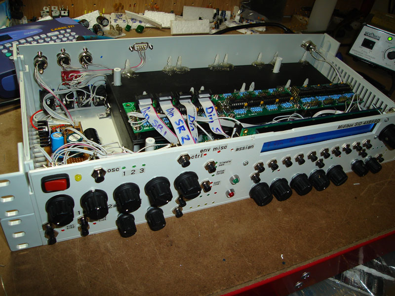

Also here are a few pics from the SID as it is now, ill post some more as I go.
All the best,
John

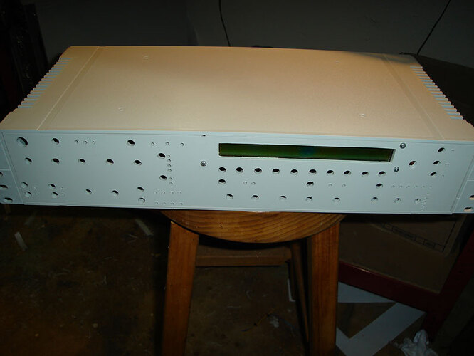

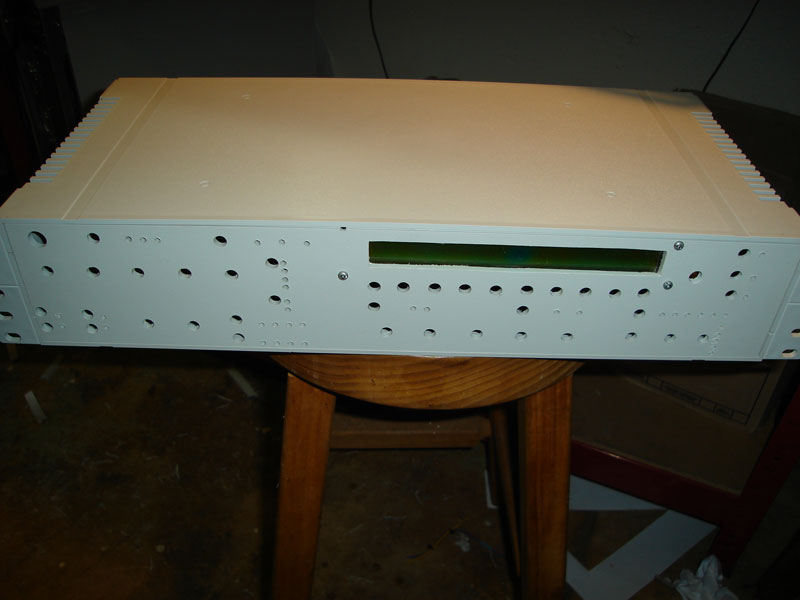

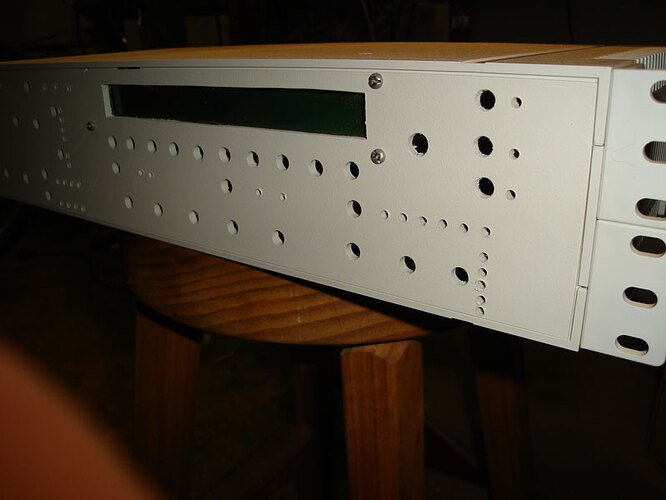

One of the front..
Its VERY DIY :slight_smile: Hand drilled and filed…
Wow! Great case!
Can I put this into the gallery? :slight_smile:

Thanks for the comment, many hours of work went into it!! Most of it lines up pretty well. Saved me a few hundred dollars in font panel! I think it looks tacky, but in a good way.

Yeh it does look good man! You’re seriously making me consider DIY’ing my panels again! heheheh
For the record, did you use a drill press for all that or was it done by hand?
Thanks stryd_one,
For the record it was all done with a cordless power drill, a very small file and a hacksaw. I do have a drill press, but I chose not to use it after my last efforts with it :slight_smile:
I have a special drill bit which helps where there is a drill mechanism on the end, and a grinding mechanism further down the shaft.
What I think helps a lot is to print out a 1:1 scaled version of your panel horizontally flipped, tape the whole font panel up in clear masking tape and drill, file and hack away until you are going to cry from the tedium, then  pull all of the tape off and theres your panel! In hindsight I would have also got a de burring tool before fitting all the LEDs but too late now. Im using a casio label printer to put on labels for the buttons and knobs, looks cheap but matches the rest :wink: hehehe. Ideally I would have done this first and then sprayed a laquer over it before putting knobs etc onto it, but next time!!
I think that making it this way is great, as I now have about $300 in my pocket that otherwise would have vanished  :o
Cheers,
John
Hah I take it that means you don’t recommend it? What happened if you don’t mind my asking?
Well apart from (to my friends continual amusement!!  ;D hehehehe ) getting smacked in the face with long planks of wood, metal sheets and bits of plastic I found it to be less accurate, even when clamped and you use the punch tool to mark centre etc. Also on my drill press changing speed isnt easy, so I ofen drill at the wrong speed thinking it will be ok and crack plastic sheets!!
With the hand drill I found it easier to get closer to the centre of the markings I made before hand.
Cheers,
John
Very nice work on that panel!  I drew a cardboard mock-up of my panel, but I ended up screwing the thing up so it looked like ass.  Yours, on the other hand, looks very good for a hand-made panel.  My only real concession to aesthetics was to paint my panel before grabbing the sharpie.  I didn’t even bother measuring the spacing for the holes evenly  ;D

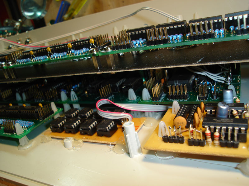

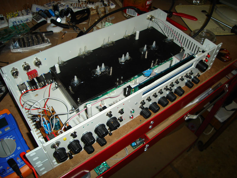

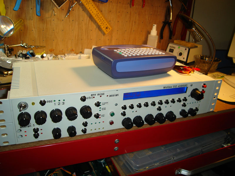

Hi everyone,
Here are some pictures showing the progress of the SID synth. I think the bottom one shows how the LCD looks a lot like a C64 computer screen :slight_smile:
All the best,
John

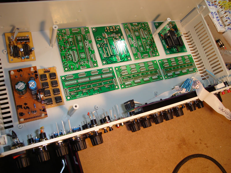

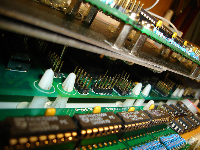

some more…

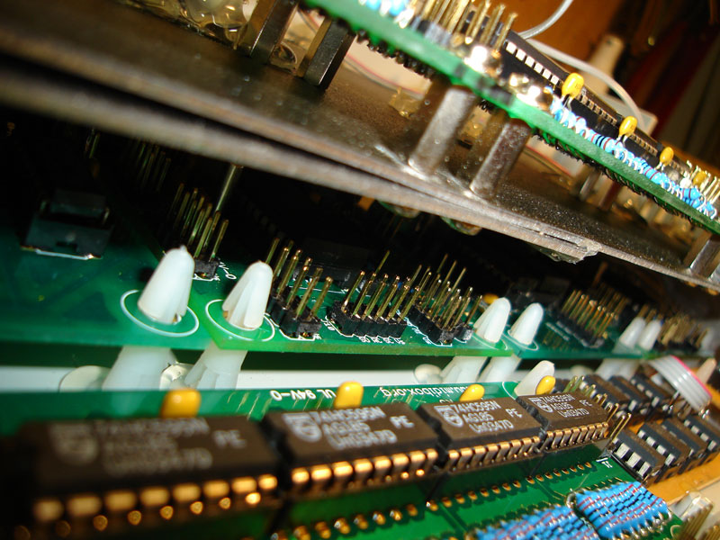

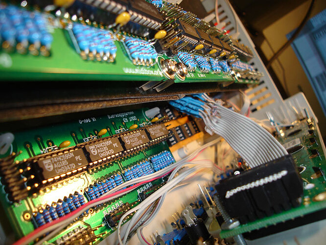

more again…
