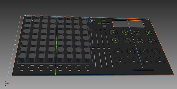

Hi everyone! I’ve finally finished the layout of my Midibox. It’s going to be used mostly for Ableton Live.
Enjoy the pics :slight_smile:
Overview..
Left:
8x8 Livid Pads - Going go to have Bicoloured LEDs (The boards only have 2 holes for the LEDS :()
8 x Icecube Buttons
8 x Pots for volume on 8 tracks
Middle:
Faders and buttons all around :slight_smile:
Encoder and buttons for LCD Control
Right:
16 encoders with LED rings.
20x2 LCD
Xfader
I still need to add some more buttons for transport control near the bottom, but this is pretty much it :slight_smile:
Any suggestions?
The bicolor LED issue has discouraged me from using any of the pre-made button pad PCBs - how do you plan to overcome this?
:slight_smile:
:slight_smile:
I found some that have two leads. So hopefully i’ll be able to hack that in, if not i’m going to drill out current holes and build a daughter board. It’s quite excessive to build a secondary board just for LEDs (and if i did that I would use RGB).

what kind of case were you going to put this panel in?
