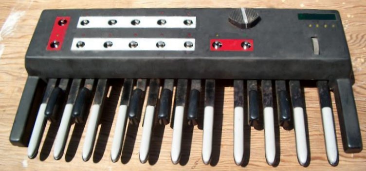

Do have pictures of your beast?
Im shure there are more people here then me that
would like to see it.  :wink:
Hi Foona,
Here is my ‘beast’, as you call it, you’re probably right,  :smiley:
It’s not a great picture, but it will give you an idea. It’s working very well, now, except I can’t figure out how to keep the LEDs for ‘OnOnly’ mode buttons, to stay on until another is pressed. Ah, one day!
Just for those curious about these things, the menu buttons are actual LEDs sitting on top of tiny micro switches. They don’t fall out as the LED base flange keeps them in the hole, and the switch keeps them in place. But the neat thing is they light up when pressed!! It was a fiddly assembly but it worked out.
Also, just to the left of the LCD, behind the LCD green plastic cover are the RX and TX LEDs.

Now that is a beast!!!
Very cool!  8)
You can also do this with larger LEDs (e.g. 8mm ones) to get really nice and cheap illuminated buttons (scroll down to see the discussion on some more robust alternatives).

Great to see all those inventions. I used micro switches from old ‘mice’ and mounted them on a small piece of vero board, then put a dab from a hot glue gun to the bottom of the LEDs and sat them down to cool with a flat surface to the bottom to push the switch.
