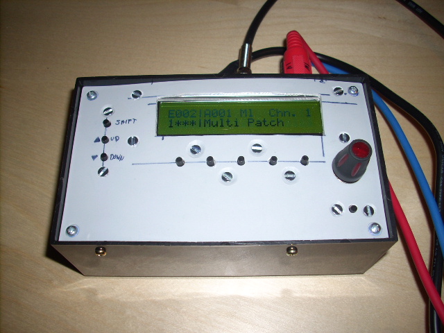

My finished MB-SID
hi folks,
Everyone wants to build one of these huge 8-SID-Wilba-Monsters - Me not.
I’ve planned to build a simple 2SID-midibox, but then got stuck in troubleshooting.
I’ve ordered another Core-kit from Mike, an this time everything went fine.
At that time I just wanted to PLAY!!!  fortunately I had a cheap enclosure lying
around which seemed to fit perfectly.
I know It looks pretty ugly, but it’s the sound that counts.
some information:
SID : 8580
Feedback pot planned, -> no external audio in
the yellow shrink tube thingie is my bankstick
