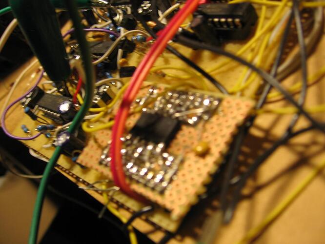

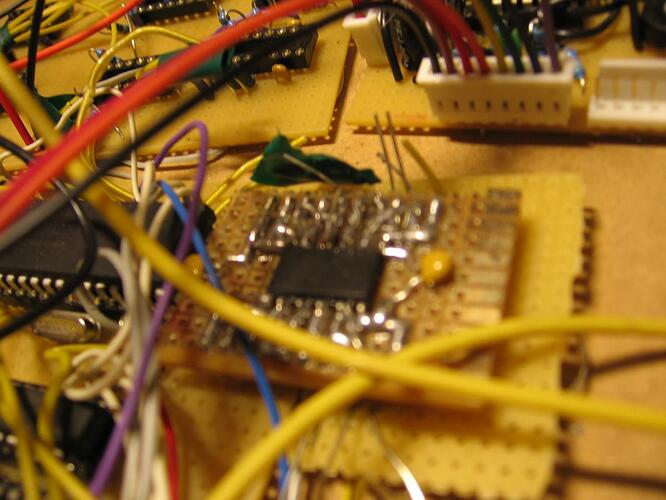

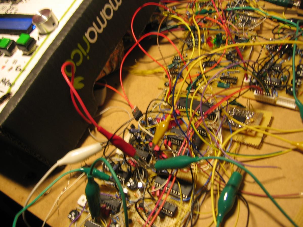

Sorry, i have schematics, but no board layout. I am a veroboard guy… I refuse to learn any layout software…
I am happy i found a good way to solder SMD. I carefully bend every second leg upwards. The remaining pins can be soldered nicely to a veroboard. The bend pins will be soldered using short bridges (cut resistor legs). I use this a lot to perform crossings (like multilayer) or connect ic pins, etc. Quite sturdy, of course you musn´t apply preasure, so whatch out when changing chips. It´s definitly quick compared to strapping wire.
Anyways, i like working like this when there is a good audio book around. Kind of fun looking for the shortest signal path as you go along filling the board

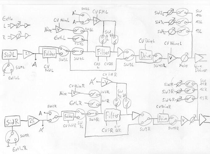

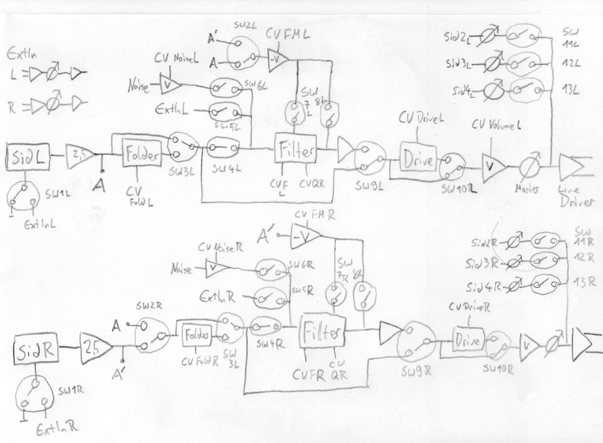

Here you see a block diagramm of the signal flow.
-A buffering amplifier brings the sid output to a more roboust level.
-Folder, Filter and Overdrive are chained and can be switched in and out (see extra diagram below).
  • FM and Highpass are part of the Filter-schematic
Signal and CV switching
Most of this is propably self explaining. Switches controlled by the Gates from MB_SID. Stored with the patch. Very nice!
Switches are not selected yet, but i´ll propably go CMOS 4066 or 4053 for CVs and some Maxim Chip for Audio-Signals. Max 333 ACPP might be the choice. For 5.20 € at reichelt you get 4 SPDT switches that can be powered with up to 30v. For a compressor i would always use a relay, but this is a synth…
Maybe powering the 4000 series cmos chips from ±7,5v would be smart. makes the PSU more complex though.
I still have to test how they perform with AC-coupled signals when powered from 12v single rail.
SW 2 is different for L and R channel.
This will route the left Sid to both audio channels, making the right Sid the MOD source for FIlter FM of both channels.
SW 1,4,5 are controlled by a center off, DPDT switch on the panel.
They provide three modes for external signals:
EXT to SID_input
EXT to CEM3379 filter directly
EXT to CEM3379, Sid disconnected from filter (but still available for FM!)
To be honest, this should work, but i might not build it. If i really build 4 stereo voices, they could be fitted differently.
SW 11,12, 13 are also hardware controlled for routing Voices 2-4 to the Main out.
A Gate is used to split CV 7 and 8 between L and R channel (each cv controlling every active effect) - or - direct CV 7 to Wavefolder and distortion, CV 8 to the other effects - on both channels.

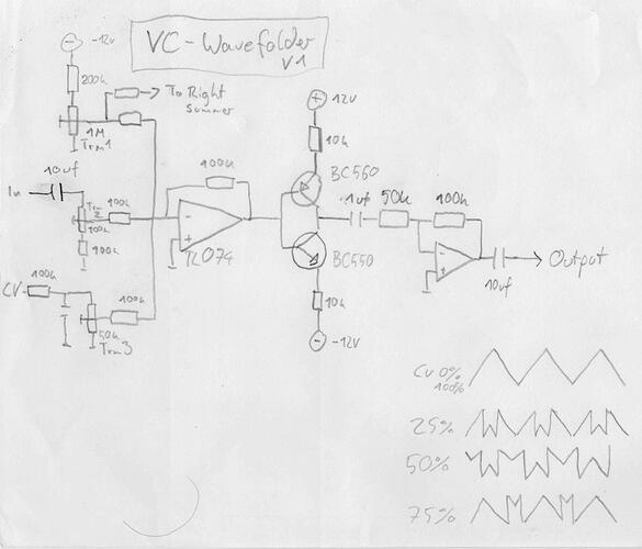

Wavefolder:
I found this little circuit on CGS. Really fascinating what it can do.
http://www.cgs.synth.net/modules/cgs52_folder.html
I found that, although this will react very much on different input levels, it sounds best when a defined level is used (so no VCA is required). I calibrated mine to work perfect with a single oscillator. Using multiple OSCs sounds interesting as well, but some sounds are “broken”. Luckilly oscillators can be turned down with the Sustain.
Instead CV is applied as an offset. On the schematic i tried a drawing of the waveform at different CV levels.
It sounds a bit like a phaser and a bit like pwm for triangle and saw.

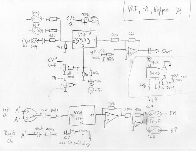

Filter, FM and Highpass:
Depending on Switch SW 2 L, R a modulation signal is routed to an inverter and VCA. FM is generated by switching the VCA output to the Filter Cutoff pin. HP by summing the VCA output with the filter Output. Since the VCA delivers an inverted signal it will cancle out below Cutoff - creating a fade to a more or less Highpass responce. Note that, if switch SW2 is on, or the wavefolder is active, things look a little different.
The rest of the Filter is more or less off the CEM3378/3379 datasheet. I settled for a slightly higher drive, giving this filter a little more grit.
Of course the same circuitry could be added to any VCF.

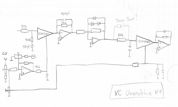

Overdrive
This can be seen as first design concept. I have to do something about the noise, propably by chaining more clipping diodes, thereby raising overall level.
It could also use some basic filtering at the output.
The overdrive itself is made by the opamp with the diodes in the feedback path - forming an unsymetrical sof clipper. You know this from the guitar stompboxes…
The first VCA acts as a voltage controlled drive-pot. The trimmer around the CV opamp will set a bias at low level so with no CV applied there will be close to none distortion.
Volume compensation is archieved by applying a portion of the CV controlling the Drive (first VCA) to a second SSM2164 VCA but without the inverting opamp, turning it down as volume raises. Remember SSM2164 is at unity gain at 0v cv and will turn down with a CV going positive.
This works very well, it can be trimmed to taste so that the percived Volume is constant or if you like, slightly raising.
If i had a 9th gate i would make it switchable pre or post filter.
But that could also be solved by building different Voices.
Pre filter is nice as you can controll the harmonics, Post filter has a more agressive touch and gives cool clipping of filter selfoscillation.

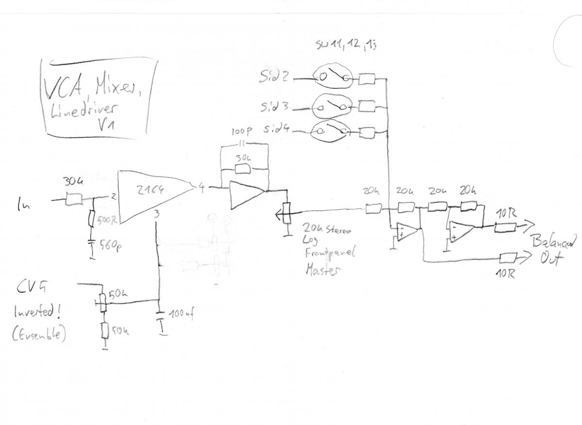

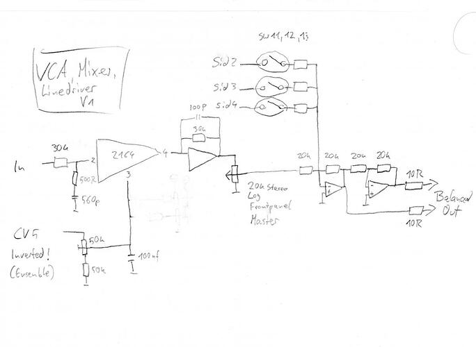

VCA and Mix
Nothing special here, only maybe that i use an unbuffered CV that is inverted in the ensamble settings. Nice feature!
Since my Studio is all balanced this is what i added for outputs.
compensation caps (47pf) across the output opamps feedback resistor are required and missing in the schematic. I use NE5532 for it´s 600 R drive capability.
