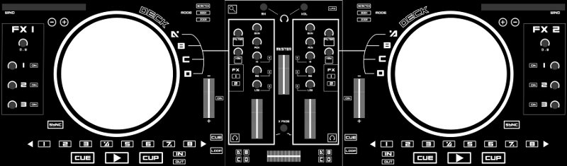

Ok,so my work start :
The interface :
Larger view of the mixer :
With the light effect (a simple leds for the moment) :

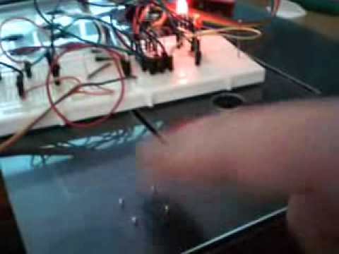

The test platform with an arduino :
The contacts (it’s simple pinned)

I just make some test with a simple BC 337 and it’s work good as http://www.youtube.com/watch?v=StshNHY_3E8.
Advantage :
Very low cost 7$ for 100 pieces
Inconvenience :
Need a direct contact
So for a price reason I think that I’ll use this BC337 solution.
