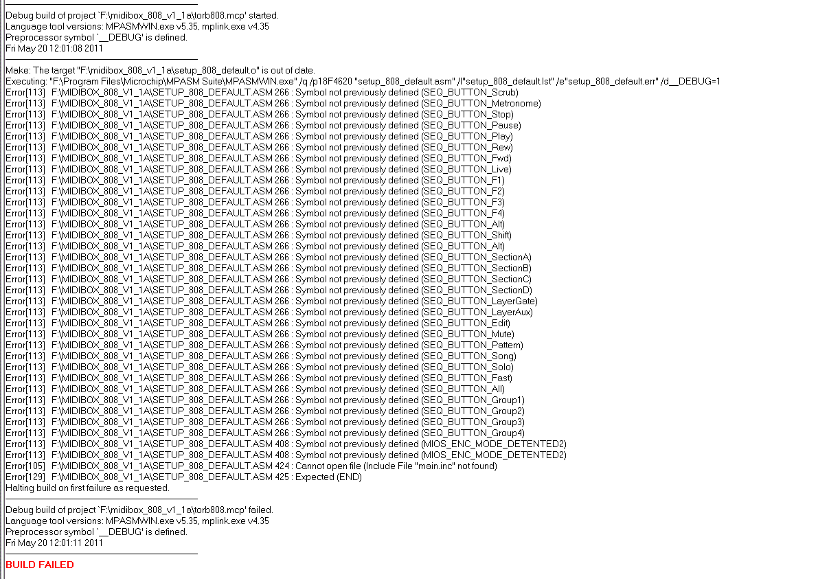

I’d like to modify setup808 default.asm, I use mplab v8.46 + mpasm (pc version).
When I click to compile this file I have plenty of errors (for this try, I don’t modify anything in the asm file, just try to compile it!)
you can see these errors in the attached file.
I’m sure these errors are newbie problem…
help is welllllllllllllllllllllllllllcome
thank you
now the missing window capture :geek: :geek:
MPlab is supported any more, only SDCC. You need to set up the software environment as outlined here: http://www.midibox.org/dokuwiki/windows_toolchain_quickstart

Warpboy
The MB808 is pure assembly code and doesn’t require a C compiler.
In order to build a new .hex file on a Windows PC, you have to install gputils and MinGW (as a Unix replacement to execute the Makefile)
On a Mac or Linux PC, you only have to install gputils.
Then go into the application directory and type make -> done
It should even be possible to create .hex files without the Makefile mechanism (so that you don’t need MinGW), just execute the commands directly in a command shell or from a .bat file:
gpasm -p p18f4620 -I./src -I ./include/asm -I ./include/share -I ./modules/app_lcd/dummy -I ./modules/iic_midi -I ./modules/aout setup_808_mbseqv3_hardware.asm
gpasm -p p18f4620 -I./src -I ./include/asm -I ./include/share -I ./modules/app_lcd/dummy -I ./modules/iic_midi -I ./modules/aout setup_808_mbseqv3_tk.asm
gpasm -p p18f4620 -I./src -I ./include/asm -I ./include/share -I ./modules/app_lcd/dummy -I ./modules/iic_midi -I ./modules/aout setup_808_tk.asm
gpasm -p p18f4620 -I./src -I ./include/asm -I ./include/share -I ./modules/app_lcd/dummy -I ./modules/iic_midi -I ./modules/aout setup_808_default.asm
gpasm -p p18f4620 -I./src -I ./include/asm -I ./include/share -I ./modules/app_lcd/dummy -I ./modules/iic_midi -I ./modules/aout setup_808_with_swingpot.asm
[/code]
thats all!
MPLAB isn't supported, and I don't see the need for this (too cumbersome and error prone)
Best Regards, Thorsten.
