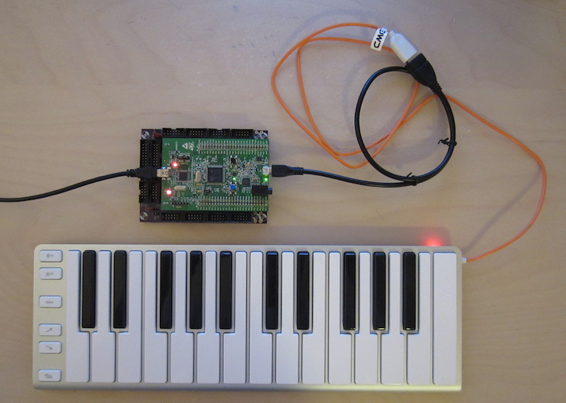

Just noticed that my CME X-Key sends polyphonic aftertouch as well, which should give me a nice testing basis:
Best Regards, Thorsten.
