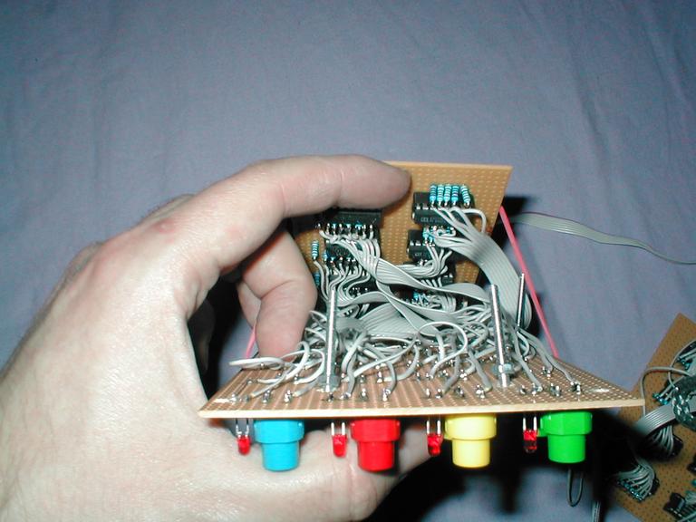

Ive seen pics of people pots that look to be mounted into a pcb or veroboard.
Is there an easy way, rather than a single wire to each pot connection?

Hi Mitch,
no, there is no easier way. But so long as you are using ribbon cables (known from computers), it isn’t much effort, since these cables are very easy to solder.
Here an example:
Although this wiring looks chaotic (since it has been made very quickly), it still works without failure.
Best Regards, Thorsten.
