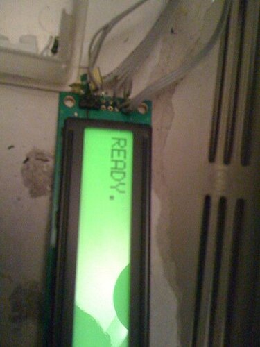

So I’m trying to get my LCD display to work now - I’ve got it wired as described in the wiring diagram - the only difference is on my LCD, the backlight power +/- is reversed, but I tackled that..
I checked every pin with the multimeter and they’re all connected to the core properly.
According to the wiring diagram, I’ve wired up my screen in 4-bit mode, which it tells me is suitable for PIC18F4685 projects.
So, i’m using MIOS Studio to try and send a ‘hello’ message to the screen, but there’s nothing on it. No black bars, no text, nothing - only the backlight. I twiddled the brightness/contrast pots like mad, but still nothing.
The only thing I noticed is that the wiring diagram describes putting a 1k resistor on J15/D3 - do I need to do this?
Cheers all!
Ahh..
My bad! I used a molex connector to connect the LCD to the core - it just needed a little bit of filing down, it now sits snugly in its place..
I now have the ‘Ready’ message on my screen! One small step for man, one giant leap for my Midibox SID!
