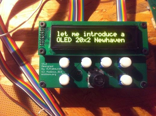

I have the Newheaven one and tested it already. You can see it here: link
But i think without any reprograming the SCS is made for a 2x20 Display.
I ordered that 2x20 type OLED from Newheaven last week and it should arrive tomorrow or so.
As soon i have it working i will make you a Photo of it.

am quite sure the Newhaven 2x20s will work - you will love them, they look brilliant!
Many greets,
Peter

I routed the pins to wrong Connections… It died right on the first attempt…
The SCS Board is a trial to get in to PCB Ordering and making… I will sell the left over Boards, as soon as i have one that works… :-)
Are you interested in one?

or if you want i can send you one piece of the PCB that has the Display wire crossed over…
You wold have to cross each second wire for the right connection… I don’t want to earn anything on those…
if you send me a PM with your address i can get information about the postal cost and send it for that price…

Look, i got it Today! It looks brilliant!
I can send you a PCB for 5$…
