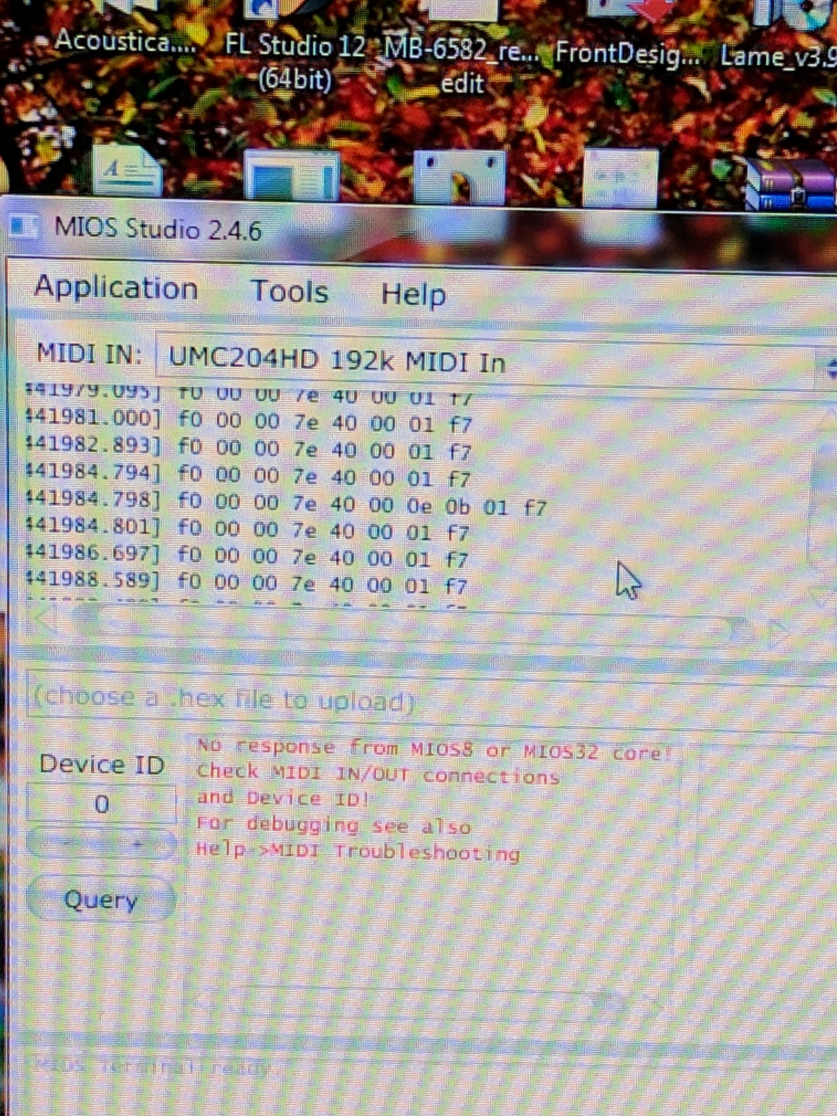

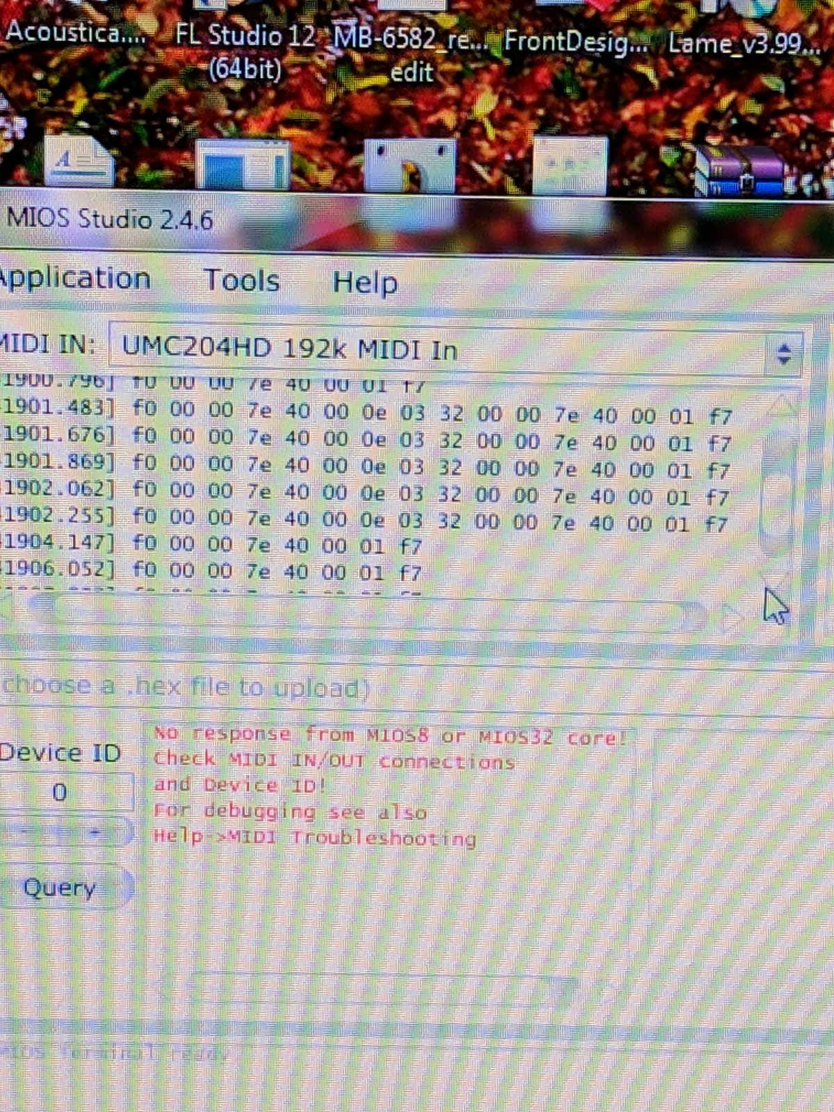

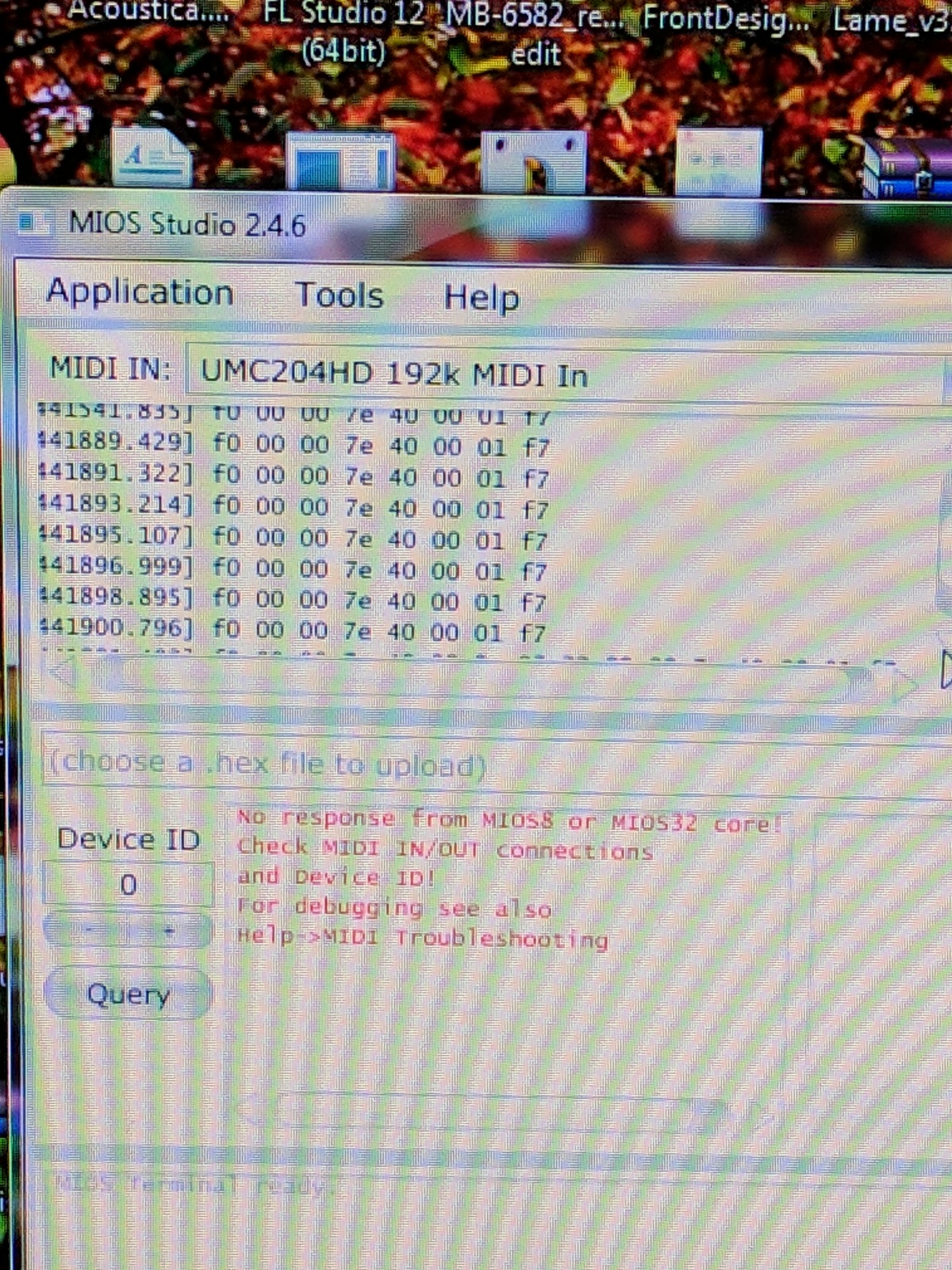

Ok, tried again.
I’ve attached photo to show exactly what happens.
The first photo show the messages that flood when I turn the PSU on with any 3 of the 4 PIC loaded in any single core.
The second picture shows what happens when I query the same 3 of the 4 PIC’s
The third picture shows a different message that will OCCASIONALLY appear when doing a query.
These events are the same in all positions on the PCB and no matter what Device ID is set in MIOS
The 4th PIC generates no messages no matter where it’s seated.
So, probably either no bootloader is installed, the MIDI communication has a hardware issue or the PSU is causing the PICs to not initialise properly.

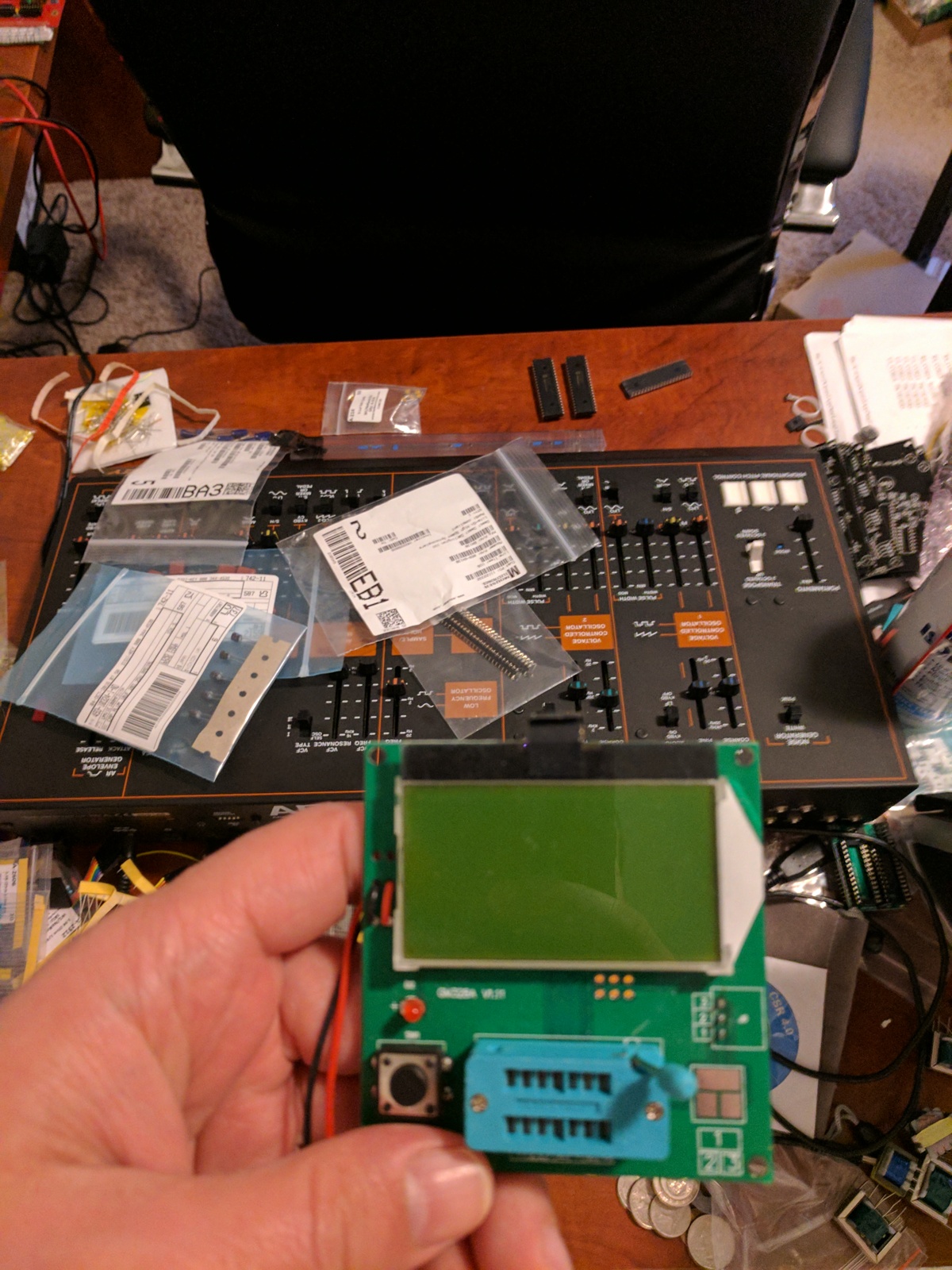

Even the caps and resistors I buy I test with this handy little thing (pictured).
