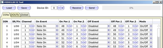

The MIOS Studio looks like this:
The problem seems to be that the Note Off in the Off Event is replaced by Disabled. If pressing Send all of the Note Off’s are effectively removed.
I had to use the old fashioned way of using Midi-Ox to send the syx file to restore the function.

Here’s some more information:
I pressed the Receive button first, so what you see in the attachment is what came out from a correct INI file (converted to SYX) and loaded by Midi-Ox.
I can also see that CC’s are correct. PC’s have Disabled in the Off Event and are coded OnOnly so I presume this is correct. I only have NoteOn/off, PC and CC in my application so I don’t know about other status bytes.

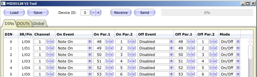

Most of my inputs are Program Change messages so the OFF function doesn’t matter.  I entered 25 lines of Note On - Note Off messages, up loaded it and all was good.  I then went back, received the config so far and proceeded to add another 8 lines of Note On - Note Off messages and upload.  They all checked out fine, but the notes of the previous 25 lines all kept playing.  I went back and had a look and they all had disable in the OFF message side.  I fixed them and went back and found that the other 8x had then done the same thing.  I re-entered all 33 lines and everything is now fine.
I can imagine if someone had many lines of Note On - Note Off messages this would cause a great deal of confusion and frustration.
In looking at it in detail I can report that trying to load a saved .syx file doesn’t show the Note Off messages, and retrieving the current config from the CORE8 doesn’t bring back the Note Off messages.  I hope this helps in trying to fix this.
