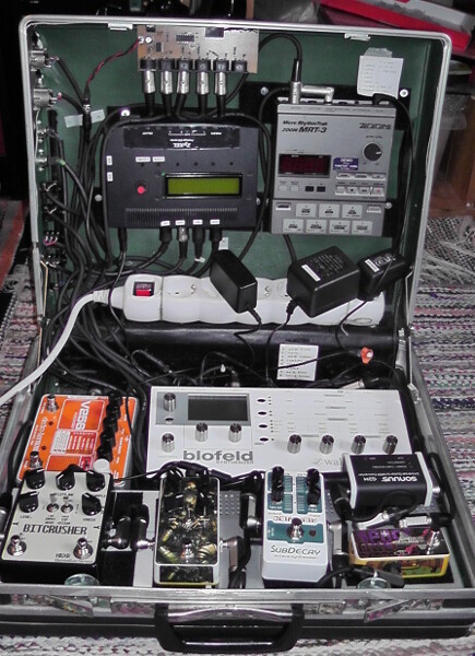

The setup idea was the third one on your list, i.e. controller -> MIDIO128 -> various midi equipment, no computers involved. It was for an guitar FX / midi case I’ve built for easy portability and band rehearsal purposes (and why not for use in the studio as well :-). Our keyboardist already has two full-sized keyboards on the stand, and adding a third one (with an extra stand) felt unnecessary, had the USB option been available in the form I originally thought.
From what you write it sounds like a USB-powered minicontroller won’t work the way I thought it might, so maybe we have to go for a clunkier controller for the vocoder, Blofeld & Midibox sample player (under the guitar pedals) after all.
