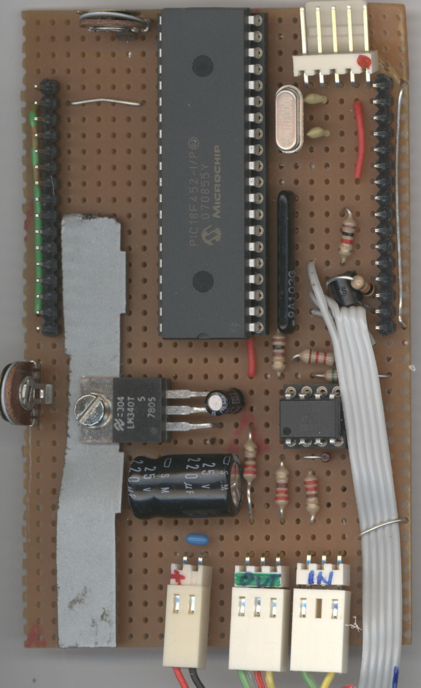

I put the whole d… thing on the flatbed scanner. Some components are hidden underneath the PIC (pull-ups and cap). The display is removed for the foto; it is plugged into the two male 16pin-connectors at the edges. The grey ribbon cable goes to the buttons. Red cables are +, black ones are ground. The yellow one goes to the luminance poti, the orange one connects the opto coupler with the PIC. Grey cables are miscellaneous connections (midi out etc.)
Well I have to say, that’s a really effective way to get nice high-res shots of your pcb! Unfortunately I’m still not sure what’s going wrong, but I’ll try to help :slight_smile:
Err, darn… that r-net is what I was hoping to look at… How is it connected? I don’t see any adjacent connections on the PCB under where the grey wires are, so I guess it’s soldered direct to the PIC socket? Whichever way, this test:
When I disconnect the resistor array from the pic pins, I measure +5V at the array pins.
Should be viewed as having suspect results because there is certainly more than one change involved between tests (remove pic, desolder 4 joints, replace pic: that’s 6 changes). Maybe no big deal, but worth noting…
I notice you were a bit liberal with the solder… Even at such high res and zoomed into 200% I was not completely sure that the button joints didn’t short each other. I didn’t really look at the rest of the board but it’s definitely a haven for shorts, what with the veroboard and unshielded wires and extra solder combined.. It might be worth using some braid or something to take some of that solder out of the equation…

I built a complete Midibox SID that way (at least the control section). By the way, I tested all connections and even possible intersections.
The r-net is next to the PIC socket. When you look at the soldering side, pin 1 of the PIC is bottom left. R-Net pins are directly connected to the appropriate pic pins (2,3,4,5,7,8,9,10).
