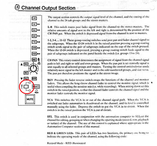

Then i would like to control the “Read”, “Touch”, “Latch” … functions with the SEL  (Cf picture) button on the channel. Originally this button was used to control the old computer.
The thing is that HUI protocol do not allow me to control this parameters. I tried to sniff protools midi out when changing this parameter and it return : B0 0C 0x, B0 2C 4x (where x is one of the eight zones).  So i send this data from my µC: B0 0F 0x, B0 2F 4x (like describe on the HUI protocol) and protools return to the µC  two sysex array :
