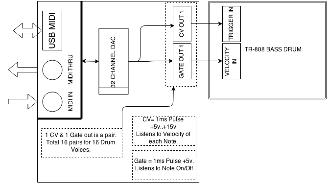

Here is a diagram for my midification project of TR-808.
I wanna know if it is possible to make and if some people want to help.
Basicly it is a Midi to 16-channel CV and 16 Gate interface that can be used to many modular synths and many other synthesizers.

Because it uses global accent from original TR-808 Schematics.
What i need is total control.
I need 16 CV that listens to velocity to control the velocity of each note received.
Aout_NG Module is ready to do this but i need 8 extra Channels of CV.
The maximum channel that Midiboxes can handle are 32 but they are limited to 8..
I think that is time for support all of the channels..
I can desing a pcb to do this but i can’t write the drivers for midibox.
It would be awesome if we had a Midibox CV with 32 analog outputs.

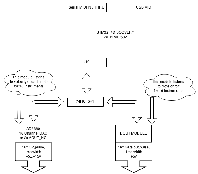

Here is another one diagram of what i need
