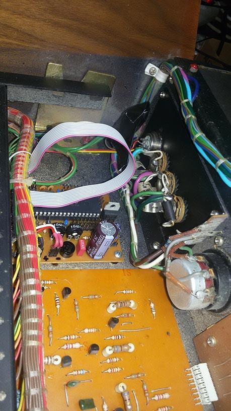

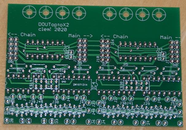

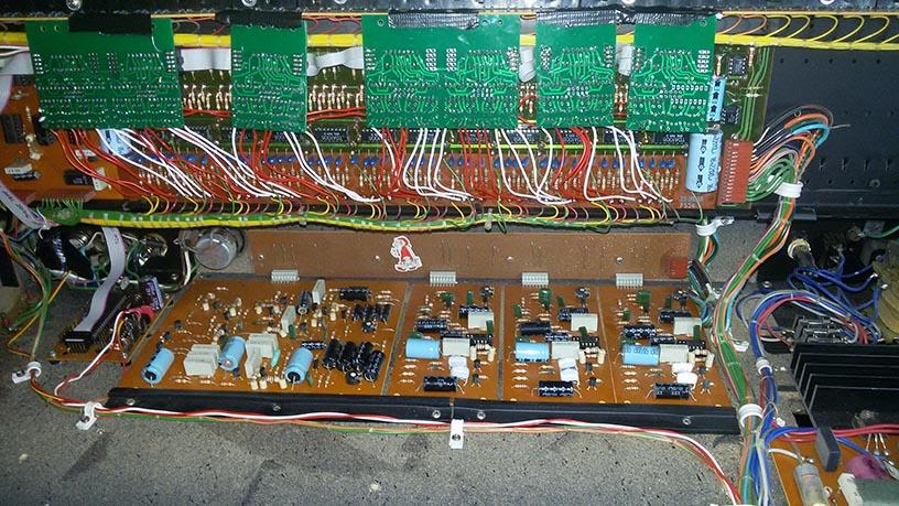

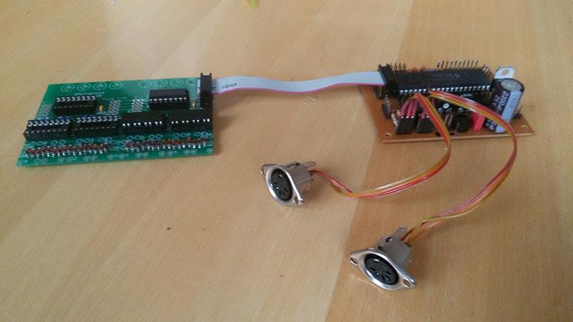

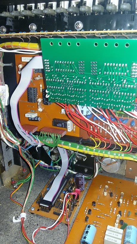

A few years ago I midificated (that means only a MIDI IN) a Crumar Performer string synthesizer with an old PIC (that was lying around from other midibox projects) and Midio128 old version. I designed a little PCB that houses the optocouplers and mounted some of those PCBs beneath the keybed. It workes fine.
But when I used it yesterday controlled by another keyboard with a sustain pedal I remembered that the sustain-pedal-functionality doesn’t work. And I would like to implement it. But after a look into the software code it seems that this will not be that easy for me. Is there anywhere a function implemented that buffers MIDI OFF messages for the DOUTs if the hold pedal ist pressed and sends them if it is depressed? Hope someone can help me.
Best clem!
Here are some pictures:

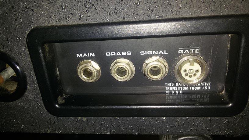

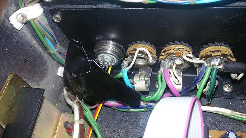

The gate connector was drilled out and replaced by the MIDI IN connector.
