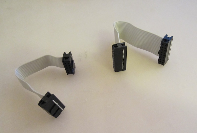

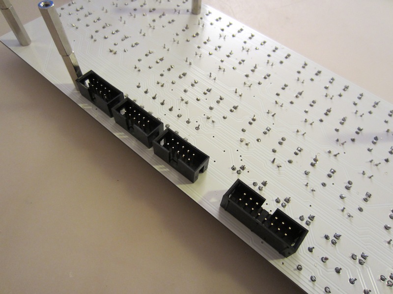

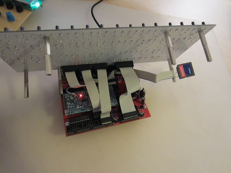

It seems that there is a problem with the SD Card connection AND with the frontpanel PCB connections.
First try to fix the frontpanel - here some pictures:
The “knight rider” effect should be visible over the complete 16 LED line for all 4 LED rows.
If it’s only visible for a single line of 8 LEDs, the issue is very likely related to the J15 connection.
Btw.: it’s important that jumper J15_S is mounted on the MBHP_CORE_LPC17 module!
It has to select the 5V option.
SD Card: in MIOS Studio terminal, type “sdcard”. This command gives you some debugging informations.
If the card hasn’t been detected, check the cables again… thats all what I can recommend with the given input
