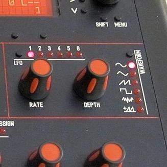

That’s what I’m thinking too, but where do you turn this feature on? For me, for example, Sine+Random light up at the same time when I have a positive Sine LFO waveform. That’s how it’s explained in the manual. You should be able to turn off this display feature and turn on the separate LFO positive LED, right?
It is installed in many MB 6582 models. (Picture attached) But when I compare the ASM files, I can’t find any differences.
