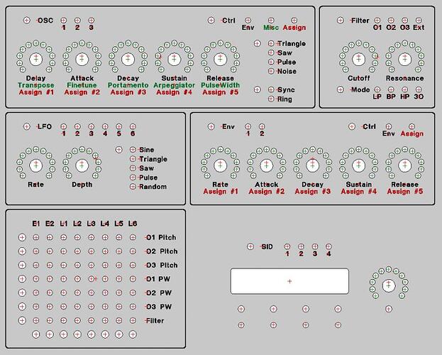

Concerning the number of required encoders - since this is really a FAQ and I don’t want to give imprecise answers to this issue anymore, I’ve started to design a frontpanel for my surface:
So as you can see: 16 encoders are required.
Btw.: not all parameters are controlled by encoders and buttons, some are only accessible with the button/jog wheel combination at the right corner.
Btw2: all parameters will be accessible over the 4 buttons and the jog-wheel. So for people who don’t want to create a big (and expensive) surface, this will be the low-cost solution. It’s also be a nice solution for a low-cost 19" rack version :slight_smile:
Btw3: it’s also possible just to left out some sections - not everybody wants this big modulation matrix
Btw4: the purpose of the “assign” controllers is to assign them to internal or external (-> MIDI controller) functions.
Btw5: SID 1/2/3/4 means that it is possible to control a lot of SIDs from this panel
Btw6: the frontpanel design is preliminary
Btw7: big thanks to NothernLight who gave me a lot of inspirations for this design!
Best Regards, Thorsten.

but one question about: will it be controlled by a second pic? or the same pic (perhaps NG?) wich drivers the sid?
and an other question: what lcd-types controlles the sid software currently? 2x16 i think. will a 2x20 also work ?
mfg
trashman

Thanks again for the applause - for myself it’s the same, I can’t wait to see all those LEDs flashing and to get a much better control over my SIDs :slight_smile: But I won’t be able to begin with the surface before february, since the MIDIbox LC/NG has a higher priority (I will receive the panel possibly next week). I also haven’t found a nice case yet (dimensions are 25 cm x 20 cm, resp. 10" x 8"), and finally my holidays are over and a lot of work is waiting in the office… :stuck_out_tongue:
Yes, the control surface will only be available for the PIC18F core, because the application requires a lot of text data for a detailed menu structure which doesn’t fit into the memory of a 16F877. Since the price of a PIC18F is nearly the same, this should be ok.
The surface can control one SID module directly, each additional SID requires an own core (PIC16F or PIC18F…)
LCD: I’m not sure if I will use a 16x2 or 20x2 - I will decide this when I start with the menu handler

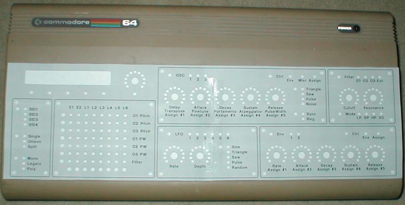

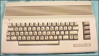

how about using the original C64’s case  for the MIDIbox SID? After ripping the 8580 out of my C64 v2 I either have the option to throw it away or make something out of it. I will try to use it as a case for the MIDIbox.
Thorsten, could you post the Schaeffer Apparatebau File somewhere, so people could use this as a template (in order to not forget any holes…)?
Thanks a lot, ilmenator
Ian: I don’t want to support ports, because this would decrease the ergonomic handling. It’s very important that you can switch between different oscillators, SIDs, etc. without readjusting the pots. However, rotary encoders are not much more expensive, and the LED rings can be left out, because when you turn on an encoder, the value will also be displayed by the LCD.
SID release V1.4 LCD support: it shows the bank name, patch number, MIDI channel and device number - nothing else… :wink:
Ilmentator: It’s a great idea just to re-use the C64 case. I’ve experimented a little with an old C64-I, here the result:
Btw.: as you can see the features are not frozen, and the panel doesn’t include all the necessary screw holes yet. Therefore the following .fpd file is only for your own first experiments: http://www.ucapps.de/tmp/mbsid2.fpd
There are a lot of expensive engraving elements at the panel, which I will remove for my final order - I will just add the labels with a foil or something else.

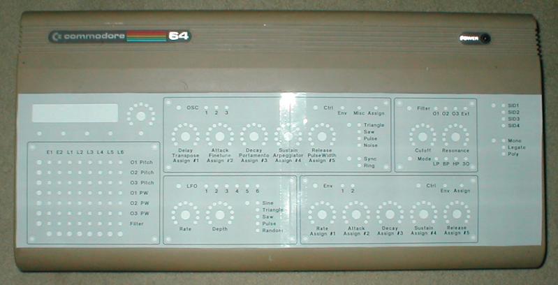

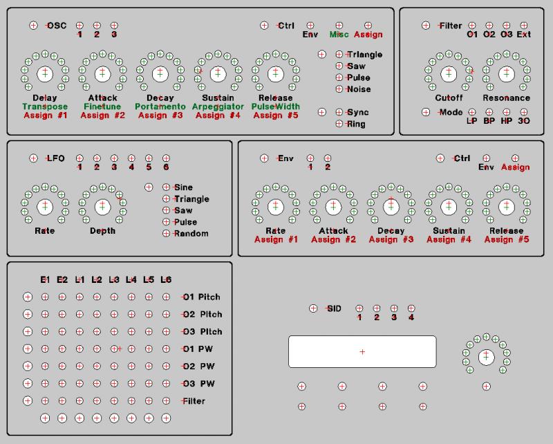

I’ve changed the layout again after I got a suggestion for the parameter structure on the display by Jan aka Captain Hastings.
It makes sense to display 5 parameters in a row according the number of encoders in the OSC and ENV section. It possibly also makes sense to provide a minimal version with 5 encoders instead of buttons below the display.
I’ve also added a new option for the multi-SID solution: “Single”, “Unison” and “Split”.
The new .fpd file can be found here: http://www.ucapps.de/tmp/mbsid3.fpd
For those who are interested: feel free to make your own modifications and introduce them here! :slight_smile:
