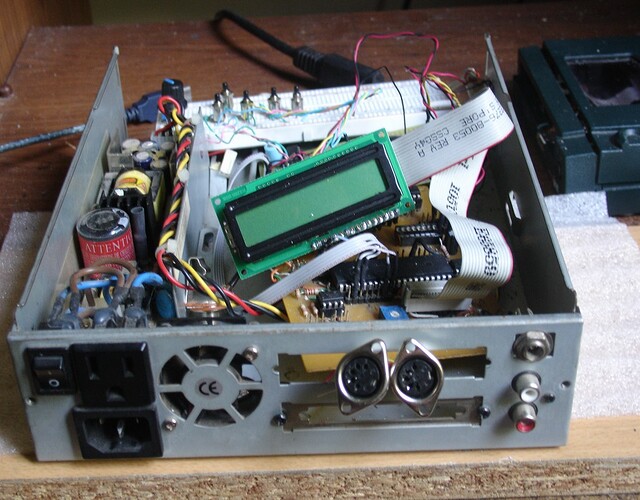

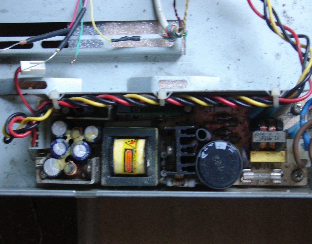

Question: is there any problem in using this power supply? :unsure:

What type of Power Supply are you using?
Could you give us more details.

The power supply is the one seen in the video is from an old external disk or something, me and 12 Vdc 5Vdc supply and stabilized (no use 78xx), we do not feel noise. My idea is to mount MIDIbox SID in that cabinet.Thanks!
Well if it hasn’t blown up your sid yet, then it should be fine! :wink:
It might be safer to use a 78xx though, just in case the voltage fluctuates.
Now I can listen to the SID, I will not lose!
The cabinet is very appropriate for a Control Unit (Step A), just missing the front panel … but the power supply makes me wonder ..?
