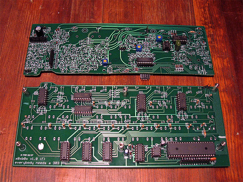

I also cut one main x0xb0x PCB some time ago to do some leveling and stacking experimentation for the upcoming mod. You can do the same, and just keep the sequencer part and use rest of PCB as a coaster. Of course, you need to assemble the part of the i/o PCB also. I`ll post some pictures when I back home.

Here is how I cut the x0xb0x PCB. Synthesizer section is untouched and has few sequencer controls like Grayhill and tempo encoders and tempo LED.
For using just x0xb0x sequencer, cut should be made above encoders, of course, and nothing of the steps below should be performed.
I soldered headers directly to the MCU pads to easily make interconnection to the synth section.
These cuts on both sides are done so I can drill the mounting hole in the corner and not make a short when tighten the screw.
