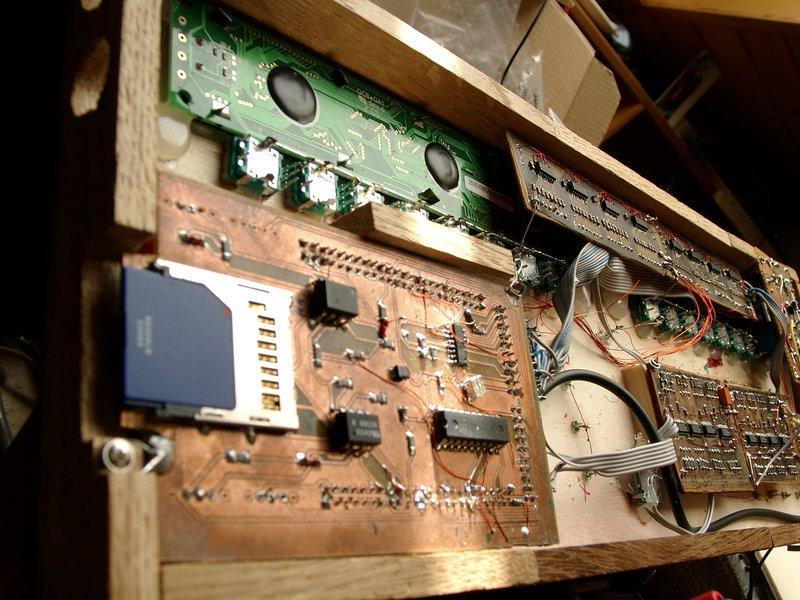

Once again that great project made me happy:-) I combined my old Midibox FM and the Midibox CV in a Midibox NG which runs
on a STM32F4.

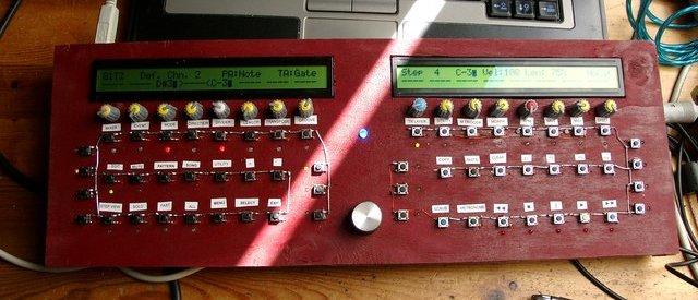

Midibox Seq_v4
01010618
01010626

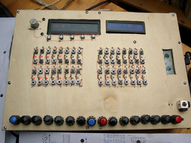

Midibox NG

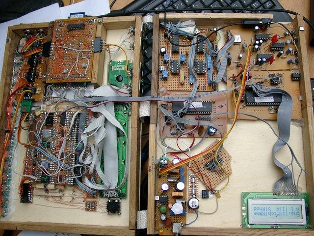

Midibox NG inside
On the left side you see the STM32F4 core with its shield and the DINX /DOUT Modules. On the right side you see the new residing of my old midibox FM, the midibox CV and a switched power supply which delivers +5V +/-12V with any notebook PS. Despite the setup with two LM2576 and a MC34063, it is very low on noise.

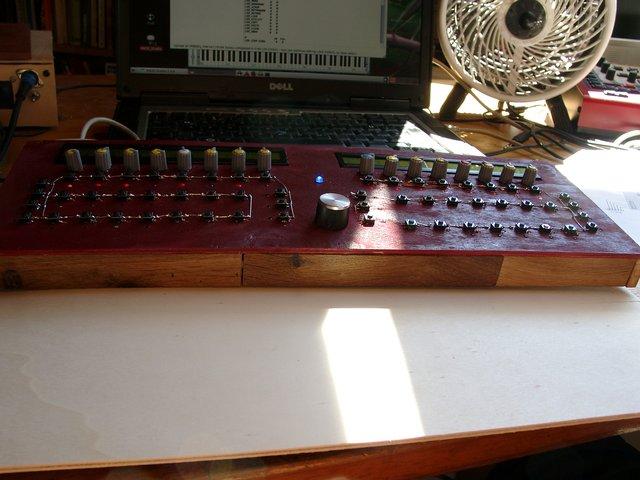

Re: 01010636
Wow! I’m not a fan of making DIY stuff look like it was produced commercially, so I think this is fabulous.
