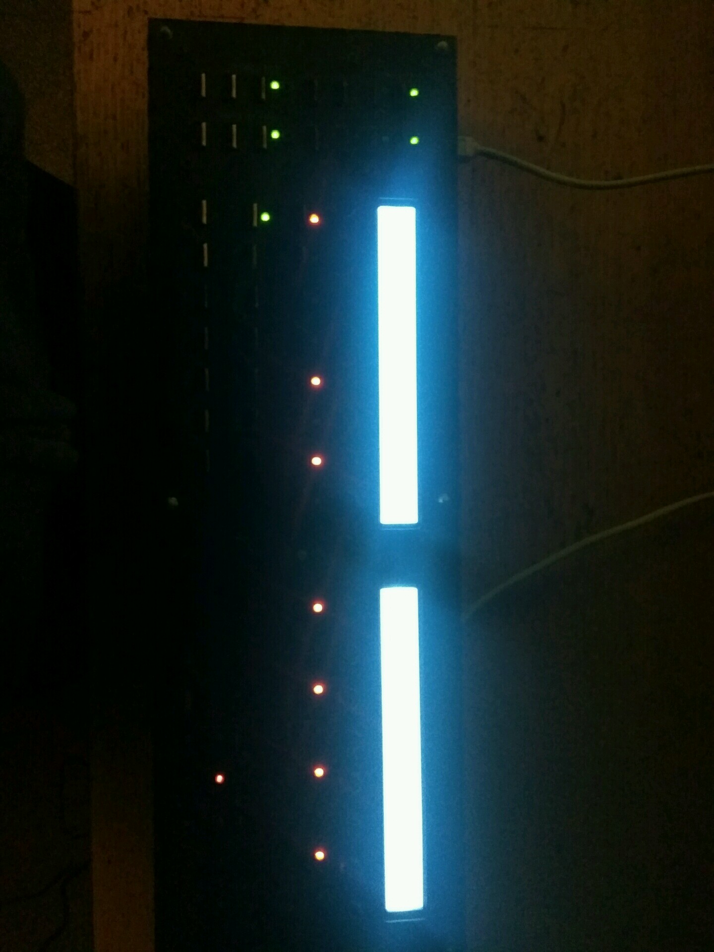

I have a problem, I can’t find away to switch the red LEDs  off on step 1,5,7,9,11,13,15 on the sequencer, they are constantly on even when inputing notes.

Here is a  pic showing what I mean.

Does this happen on every page of the sequencer?
if so, i would open it up and start checking for shorts on the control surface, like bridged solder points.
You could also reflow each solder joint to make sure, and be sure to clean the board with isoprpyl alcohol to remove any flux residue that may be causing th issue.
Did you check that the correct Wilba HW file is accessible on the SD card? If unsure, test out with the one released as part of the firmware package. You can also check button/LED behaviour in MIOS studio.

It happens on every page  same LEDs lit.
Thank you for replying too, I only have the Wilba HW file released as part of latest firmware package. (I removed the previous .91 Wilba HWfile)
I tried uploading the standard_v4 & the tk MBSEQ_HW.V4 files to see if the LEDs stay on the steps like before, The outcome no LED’s are not on any of the steps.
(Not sure if this helps a diagnosis at all)
I uploaded the latest Wilba HW file & they are back!

How are you uploading the HWCFG file? Does your SEQ have an external SD card slot? Did you try formatting the card/ensuring that there’s only one instance of MBSEQ_HW.V4?
Are all of the buttons (and encoders) working? If there’s a hardware problem with the button-LED matrix, then you should see issues there too.
I had similar (see link below) and it was caused by one of the IC’s blown. To troubleshoot I swapped some of them around and I do remember one time a random collection of LED’s came on.
