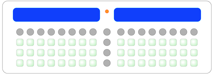

Here’s what I came up with on a Sunday afternoon:
The CS would be spilt over a few PCBs in order to save costs. Note the four extra buttons where the encoder wheel is, they wouldn’t need to be installed and the whole thing could be tighter. The smaller boards are identical too.
I would wire each main board as an 8*4 matrix, using the spare 4 DOUTs for the beat LED and maybe three LEDs/one RGB LED (top left). This way the RGB hue could indicate the track group as in the current v4, or OFF/LED1/LED2/LED3 as groups A-D. Probably SMT with all registers on board. There could even be enough space to PCB mount the other panel hardware, i.e. built-in MIDI IO etc.
I kept the 19mm spacing for encoders, sadly the adafruit illuminated pads have 15mm spacing, so it looks a bit weird connected together. I think separating them out is a good compromise (hopefully stable enough). The whole thing could be <110mm = Eurorackable. Every button gets an LED, even if they’re not used.
One issue is the lack of space between buttons makes panel labelling in the horizontal direction a bit hard. Need to check the resolution of Schaeffer’s laser printing :). Or, the labels could be done vertically instead.
Interested to hear your ideas. :slight_smile: And probably more importantly TK.'s.
Looks good. My desire would be to shrink the CS considerably (at least by a 3rd) and reduce the amount of buttons as well. However, button reduction would be a massive talkfest as it would require analysis and refactor of workflows which would impact a lot of code. Not being a modular guy I haven’t considered Euro but I agree it would have to be a requirement. Rather than clutter the thread I’ll go back into my cage and think for a while then write something up in design concepts.
Note: Sparkfun button pads have largers spacing and also come in 2x2 grids. The pcb pad footprint is also available.
Did you mean the horizontal should be 1/3 less? In my quick mock-up with boards pushed together, the total width is about  378mm (compared with 421.64mm for Wilba’s). In reality the limiting factor are the LCDs (182mm each standard), so I don’t think a 1/3rd reduction is possible.
Personally I don’t think fewer buttons are a good idea :). But for some ideas you might check out the v3. Note in the HW config file it’s easy to assign most functions to custom mappings, so even in a generic form you could leave out some of the functions. The coding question boils down to whether TK. will support splitting the matrix into 2*8*4 and adding subtle extra encoder/“group” handling. If yes, the PCB routing will be so much easier, also smaller boards are much more convenient to ship.
I did check these out, sadly the spacing is 25mm, which looks weird aligned with the buttons.. Also the cost is double the adafruit price.

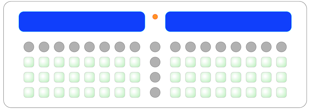

Here an alternative idea for a FP layout:
However, a potential issue with the adafruit pads is the spacing between the pads: it doesn’t allow to add labels
But labels are essential for intuitive usage!
Best Regards, Thorsten.
I agree, plus I am not convinced about the durability and longevity of these pads / the contact system these use. I would prefer a solution with proper switches.
Agreed with TK. on the one-handed edits.
The layout looks nicely symmetrical, but I think the centre will be a bit too cramped. Should tracks and groups have some sort of indication, or is it okay to just read the display? If the idea is given the go ahead, users could choose how to mount the extra encoders. Perhaps a little PCB is even unnecessary; the DINs could be fly-wired to panel mount encoders.
Also agreed about proper labelling, and it’s a crucial factor. A few points:
  • GPs might be labelled above the switches, the bottom row below – would that look weird?
  • Due to the extra spacing required to match encoders, there’s more room between columns of buttons. Some functions can be labelled vertically instead (if not too strange).
  • Some things are done with symbols already, we could consider more icons e.g. copy, paste etc.
  • For the BLM 16*16  used the recommended panel cutout. I think it would actually be okay to make the hole a few mm smaller = more room for labels.
