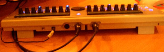

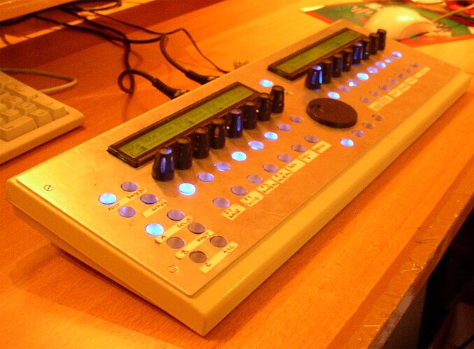

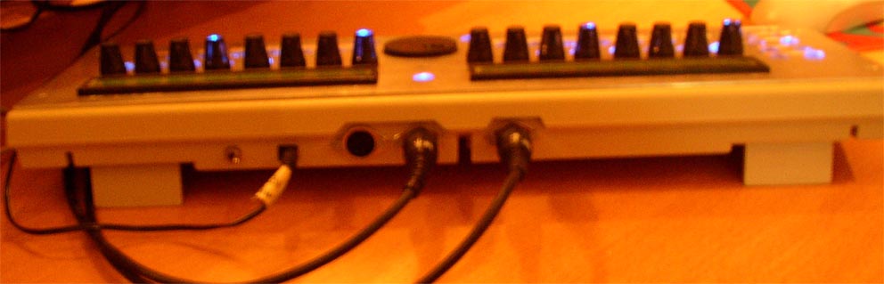

The slimline MIDIbox SEQ made by Hallucinogen - he built it into an old Compaq PC keyboard:
Looking nice! was it a tight fit?
i love those buttons where did you buy those?
hi !
thanks for your reply !!
it was a bit tricky to get all modules in the case ! i had to build the core on an a vectorboard to get smaller size. all the other stuff fits on one big vectorboard with dinx/doutx/microbuttons/encoders…
i will post some pics of the “inner life” next time i get a digicam !
