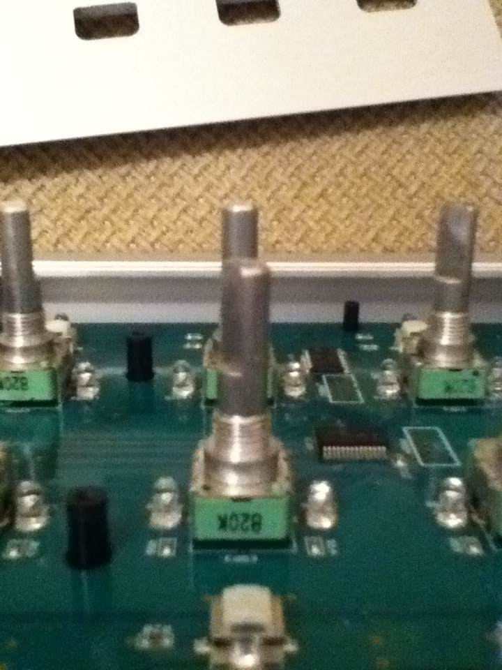

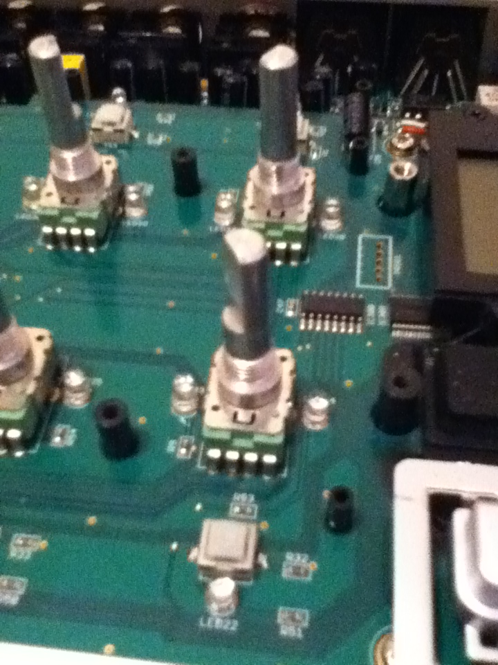

Where can I program Leds, rotary encoders, buttons, and LCD’s? i dont want motorfaders!!
For exemple, here, there are 24 tracks, i think i need 32 tracks with 3 rotary encoders, 12 buttons and 56 Leds per track..
Thanks!
You should just build a 64e with the 8-bit pic based core. There is no complete 32-bit project yet. The purpose of LC is to emulate mackie control, it seems like you want more of a custom solution. 64e will allow encoders, leds and pots in anyconfiguration you want. If you need more than 128 inputs use another core or use a matrix.
