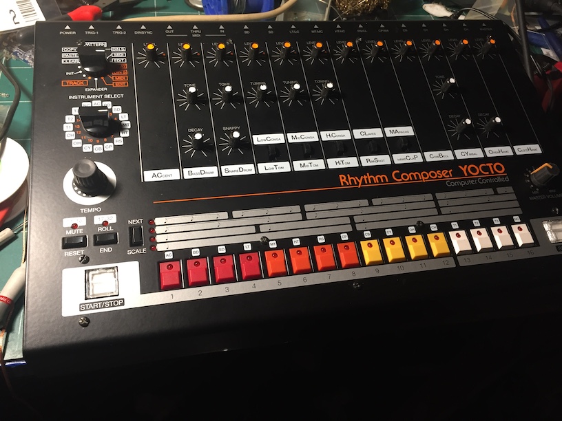

I’m interested in the software, I’ve got a Yocto 1, the bad point with this machine is the low quality pots and the ATmega firmware.
I resolve the pot problem by replacing it by 808 original set, was not easy not the same size at all! But I founda way :wink:
Now it remains me to put a good sequencer inside, a MB one :wink:
