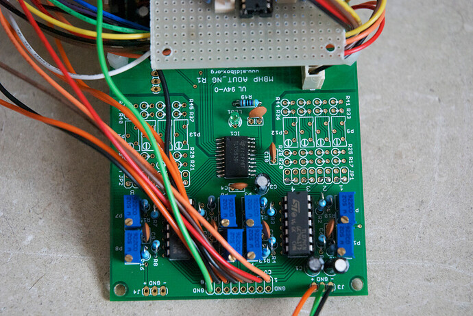

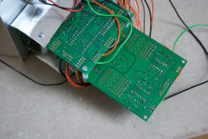

Here are a few pictures…

your soldering on TLV is fine i think but did you test with multimeter ?
are the opamps in their sockets properly ?
