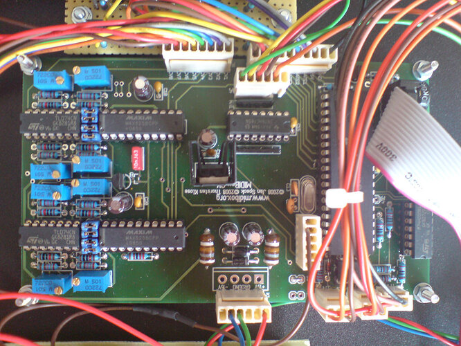

I built two midibox cv interfaces with the “all-in-one” pcb that sonicwarrior offered a few weeks ago. I think I share my experiences since there are a few traps you might fall into:
  1. The print on top of the pcb for the LM385 is wrong! you have to turn the LM385 180 degrees, or you won’t get 2,5V ..
  2. Since I used a LM385 (2,5V) instead of a MAX6007 (2,048V) I had to adjust resistor values for all R_y: 2,7k worked for me.
  3. R6 is missing in the BOM. It’s 2,2k.
  4. C11 is listed twice in the BOM. Should be 100N (not 330N).
  5. You have to put a jumper at J3 if you don’t have a separate 5V supply.
  6. There are two resistor networks  (RN1 + RN2) around IC5. For RN1 the pin-1 marking is missing: Pin 1 is point away from the PIC. I got a really weird menu navigation when I got this wrong first ..

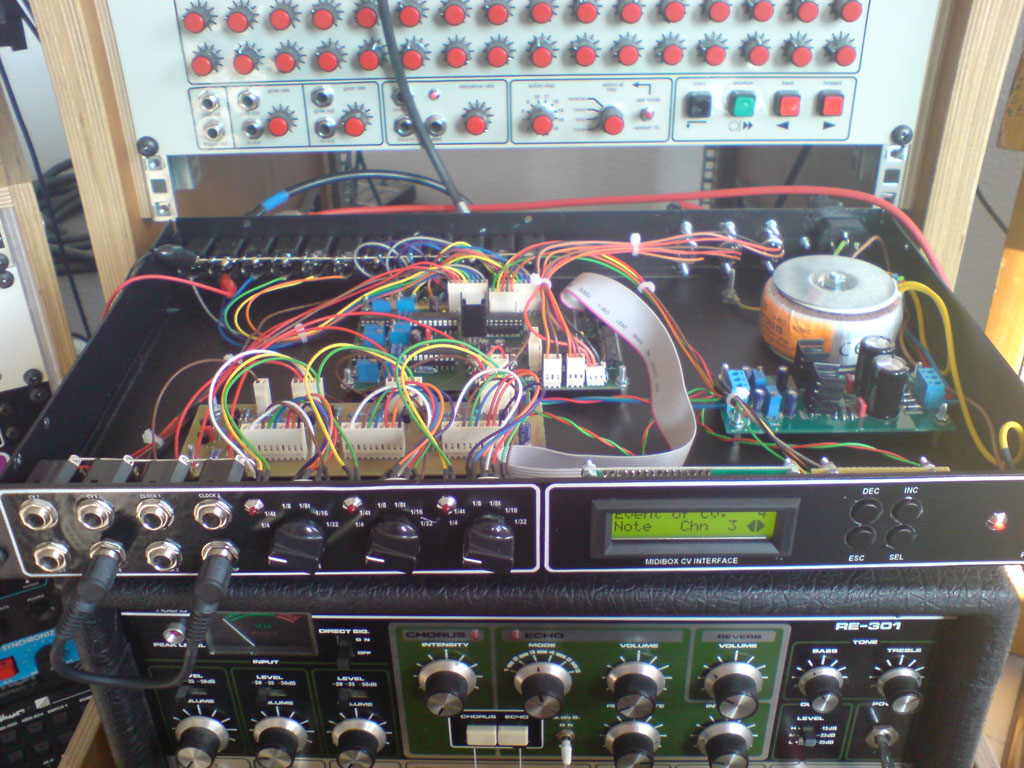

I have attached a few pics: the black one is mine, I added a Yusynth clock divider and a gate-trigger converter (small breadboard in the back) to trigger my moog & ms20.
the silver one is for a friend: no clock divider, but a much nicer front panel (schaeffer)…
