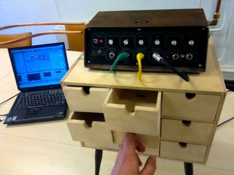

First a little introduction. Me and a friend have a little non-profit company called Elektruck. We transformed an old citybus into a mobile digital music workspace and we drive to school’s to do music workshops with the kids. (see www.elektruck.nl, it’s in dutch) About two years ago we won a big ‘cultural community’ price and a few days later we got a big secondhand truck from the government for free! The plan with the second truck is to transform it into an experimental play/soundgarden for kids. So in the first truck we got 10 little PC based studio’s with Ableton Live and the second truck we want ‘interactive music installations’. After breaking our heads over what kind of conceptual interactive installations we wanted I decided just to start experimenting with the UcApps stuff with my midibox cabinet as a first result. In dutch it’s called ‘klankkast’ witch means resonator box. What is it?

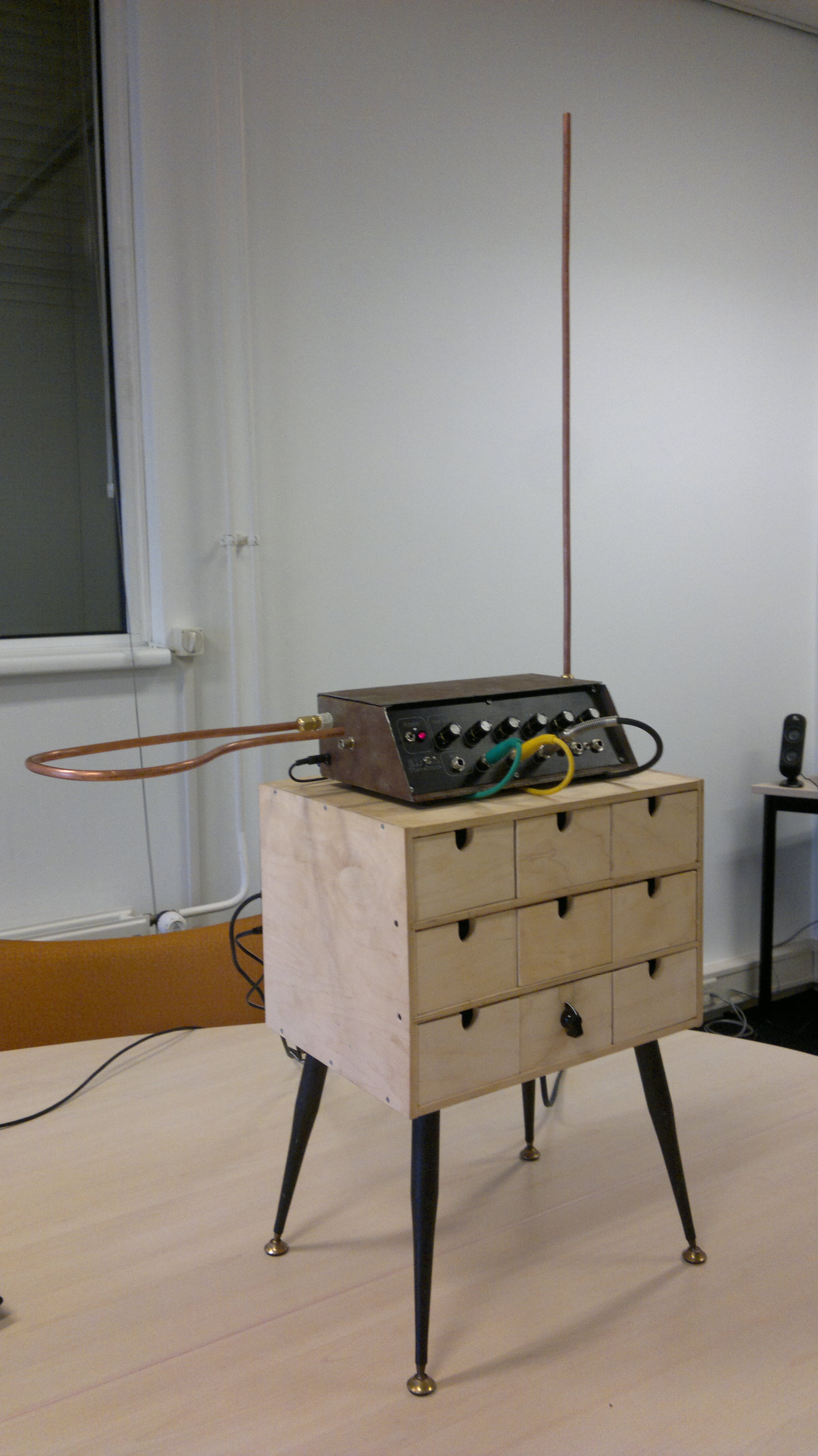

It’s just a drawing cabinet with different sounds in each drawer. By turning the knob on front you select a different sound set. If you open a drawer the sound comes out, by pulling multiple drawers you can mix the sounds. On top sits a Paia theremax witch sends out CV’s according to the reach of the antenea. Those CV’s go straight into the core and let you play with Ableton’s grain-delay(pitch)and an other delay.
It’s the most simple setup with only one core, (for 8 analoge inputs) and a dinx2 for the select knob, that’s all!
In the big truck we would like to build a huge cabinet with 64 drawers so the kids can go wild!

Can you explain what senses how far you pulled the drawer out? Is it a mechanical mechanism that moves a pot? Or is it optical?
Thanks. The technique used is really simple. I just used 8 faders and the drawers are attached to the mechanical wipers of the faders. See the attachements. This is also how I got the idea, I was playing with the faders and I thought they looked like furniture sliders. And drawers are for storing stuff, so 1+1=3. Sometimes simplicity is the best. The antenna just interrupt slider 7 and 8. The switch is an eight turn switch, witch selects just 8 different ‘note on’ events, to select different scenes in ableton.
