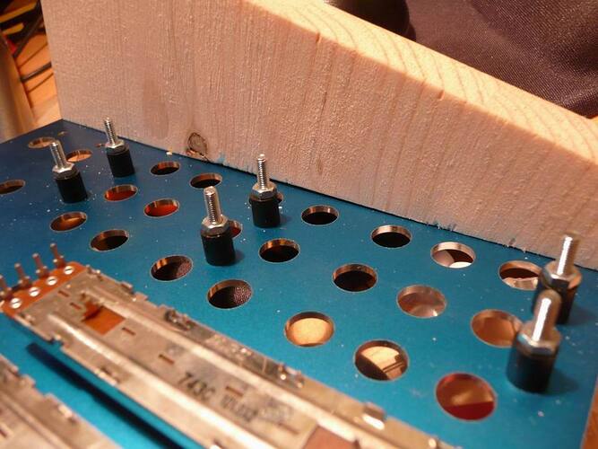

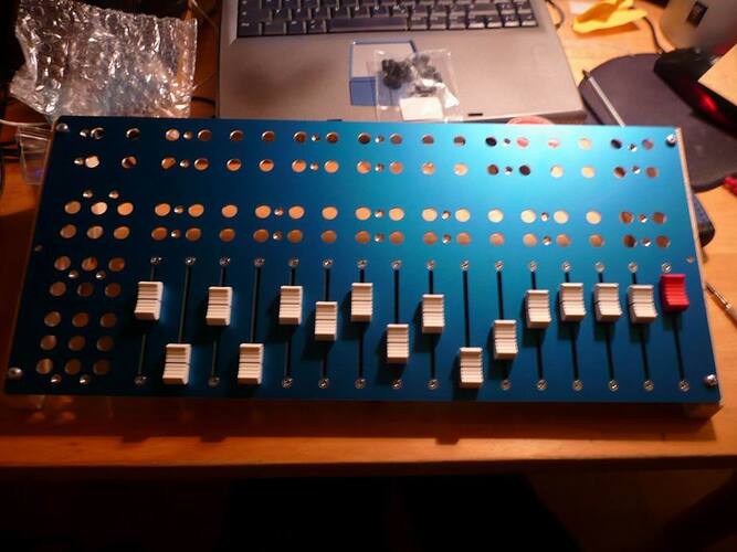

In the meantime, here are some photos:
Panel ordered from Schaeffer, already stuffed with 16 ALPS faders:
Main Control Button Board:
Mounting of the board:
Buttons in the panel:
Status as of yesterday:

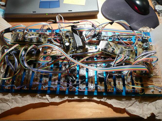

All the wiring is done.
First test run revealed there’s still something wrong with one of the DINX modules (the core won’t start) and one AINX still causes random MIDI events (some incomplete grounding of open inputs i suppose).
So I’m off for de-bugging tonight.
But the unit is fully wired, still quite compact and looks very nice (pictures will follow soon).
Sorted out the AIN problem, one of the multiplexer lines was making trouble.
Still got the DIN bug to figure out, but all analog control are running fine. Test run went smoothly :slight_smile:
Here’s the picture update:
DIN problems solved: bad soldering and mixed up cables :whistle:
However, IT’S FULLY WORKING !

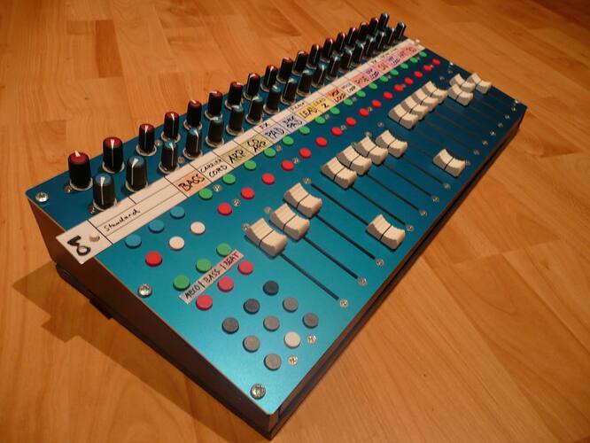

It’s finished!
I made a compact case of multiplex plywood to fit underneath the aluminium front panel.
Took some days to give it nice blue spraypaint finish, but luckily, the tone of the blue fits the panel quite well.
Also had a late idea how to fix the scribble strips, using laminated paper strips, two cannibalised IKEA plastic floor bearers, super glue and a hole puncher :slight_smile:
See the attached pictures of the finished MIDIbox which is working just as smoothly as I planned with Ableton Live (more videos?)
