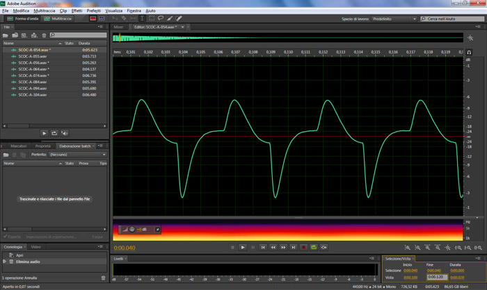

Now since I have Omnichord samples, I can’t undestand how this schematic can make such waveform (at the lowest note), and then become a triangle-like waveform at the highest notes.
