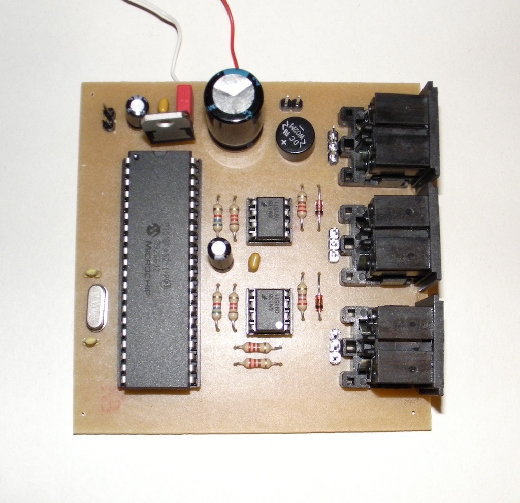

Ive also tried using MIDI In 2 on the merger instead of In 1, but same thing. Im a bit confused in general about what voltages should read on the merger, and also the pics of the merger show all different orientations for caps.
That merger pic shows the capacitor at the top left with its negative stripe pointing up towards the edge of the PCB, but then the images inside midimerger_pcb_v1.zip show the opposite.

J2 of the core needs to be connected with J 2 of the merger board. Since the merger doesn’t really have any other port, I assume that’s a typo? Semi-edit: I just noticed it’s actually called JP4 in Mike’s layout… Your caps are correctly aligned (at least they match with the pcb layout).

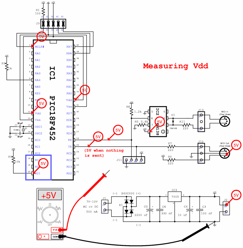

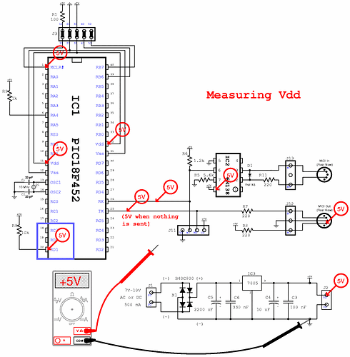

OK heres an update:
When I measure the VDD I get exactly 5V at all points I should except the one Ive boxed in blue:
I dont know if the merger from Mikes site is supposed to have 5V at that point as the above image is just general core measurements, but Ive resoldered the joint in question and its just 0.0V.
Also I took the PIC out of the merger and put it in my working core and still get ‘no response from mbhp core’ in MIOS Studio. So I presume this means that if the above joint is not supposed to be 5V then its because my bootloader isnt burned. If this is the case how would I go about getting it burned as I know nothing about this process. I requested a bootloader to be loaded when ordering from Mike.
Thanks in advance!
