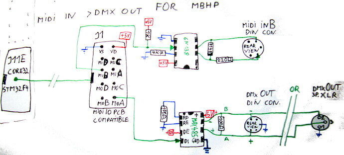

In the meantime i made a shematic, and soldered the Test-Equipment:
ATTENTION - the Shematic has a Error — the DMX has to be connected to MOB instead of MOA!!!
