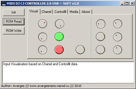

Today i have released english-interface software and new firmware: http://avargesnano.narod.ru/MIDI-DJ-CJ-CONTROLLER-2.0-USB-14.02.10.zip (page http://avargesnano.narod.ru/MIDI-DJ-CJ-CONTROLLER-2.0.html )
*Software has crash on the start if no MIDI input devices is in the system (so i start it after connecting my device). i will fix it in new version.
