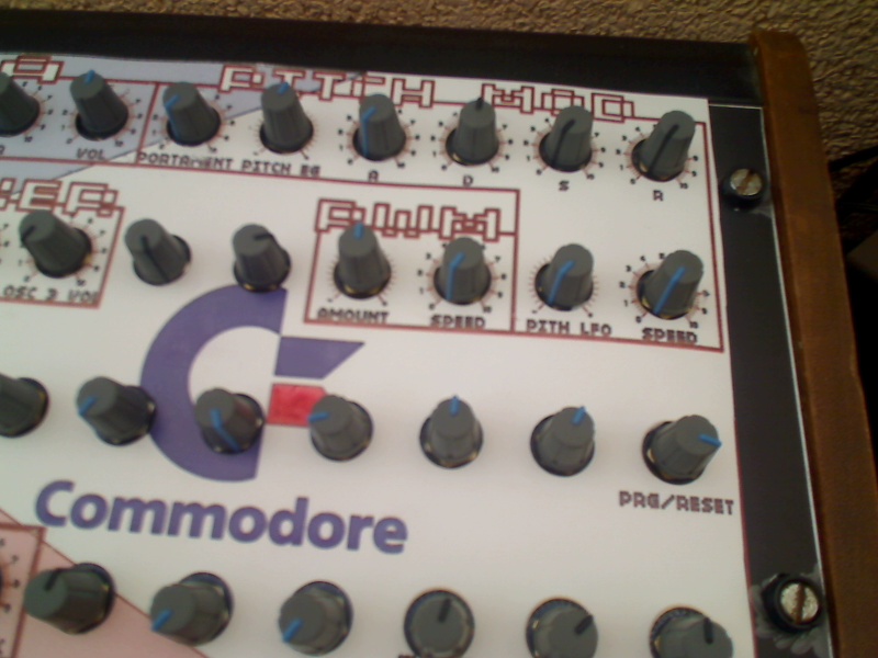

here some picts of the thing… just to show you it  8)

Thats a great case design! :slight_smile:

about the desing of the case, thx… i am thinking on help on something to this proyect , i made the front panel and print over a “plastic” strong and easy to drill material, if somebody is interested i can do it for them for only the price of the material and post, i have all the equipment to do it because i work on a printing company, i dont want in any way to make bussines with this, thanks you and this site now i have a couple of pieces of incredible gear and i follow the spirit of this, so if you think it can be a good idea please let me know.
