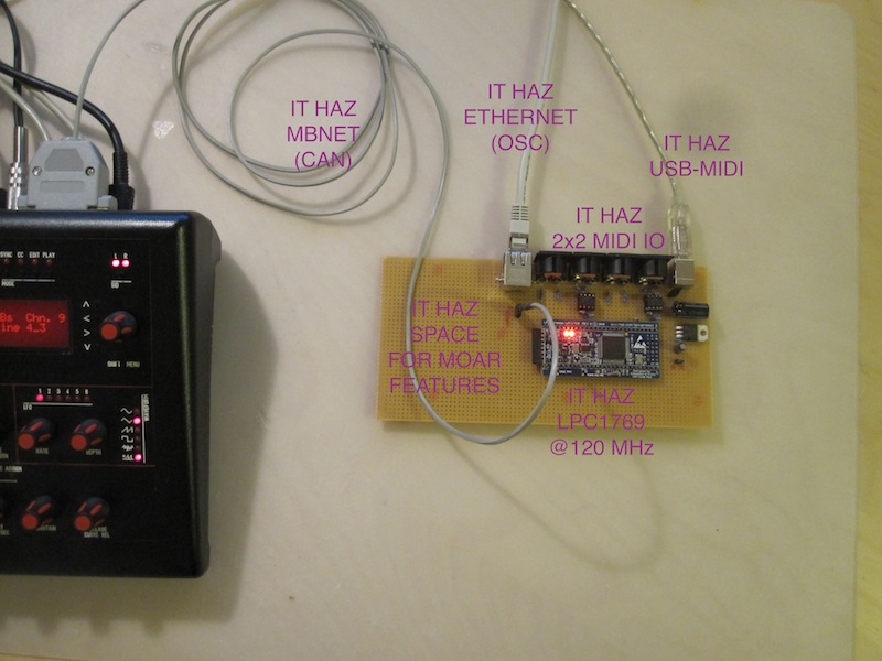

For those who prefer pictures:
The LPCXPRESSO board is worldwide available for ca. 20 EUR + taxes: http://www.embeddedartists.com/products/lpcxpresso/lpc1769_xpr.php
It’s completely presoldered and tested.
It will be put on top of the MBHP_CORE_LPC17 module which will provide the PSU and interfaces to the MIDIbox Hardware Platform.
-> back to DIY friendly design! :slight_smile:
