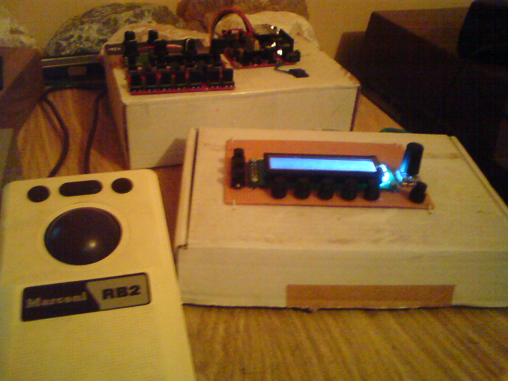

MBSid V2 running!
years go by (literally) but now i’ve almost finished my 1st midibox Sid V2!
it’s a step B minimal stereo 8580 setup with 8x BankStick. i just temporarily put it in a cardboard box.
it’s running, but i still have to figure out some minor stuff, like changing the encoder settings. atm it’s going 4 steps per move.

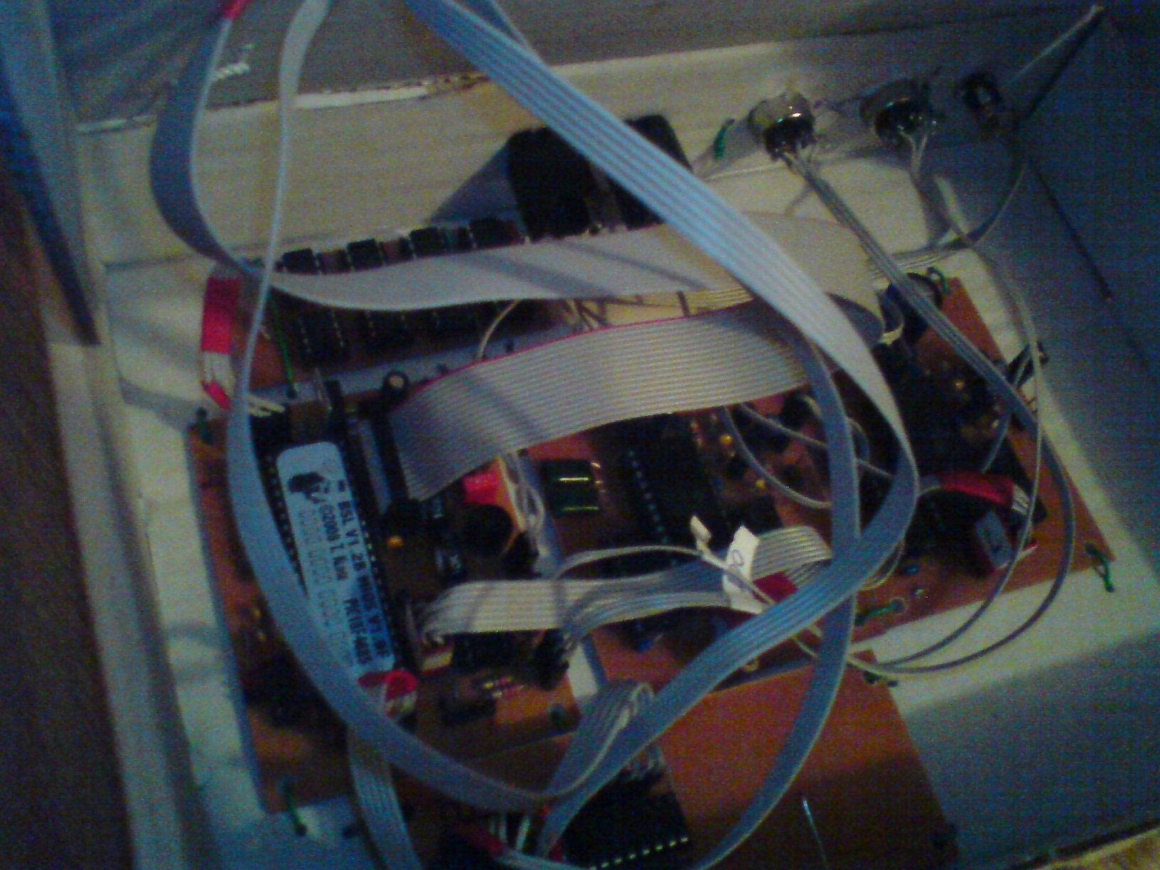

ok, after updating mios and installing the sid firmware again the encoder works fine.
i still had the impression that there’s no real stereo… the impression was correct. after reading the appropriate part of the documentation again i cut the cable between the 2 sid boards and made a new connection from J14 of the core to S0 on the 2nd sid module.
works!
