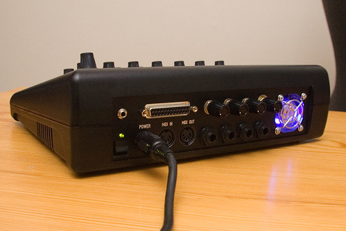

I guess you could use the “general purpose connector” that is included in Wilbas design to connect
a self made breakout box containing the AIN’s and AOUT’s:
You would have to wire the connector pins to the required pins on the PCB
But get confirmation from the pros here first I am not familiar with this box.
This would absolutely be possible.
AFAIK  the existing MB-SID firmware provides no functionality for CV inputs, but it can output lots of stuff via AOUT.  You can route audio through the SID inputs with no additional hardware.
The MB-6582 puts the entire “standard” MIDIbox SID components on one board, yet the Cores still have full connectivity for other MBHP modules.  AOUT / AOUT_NG could connect to the MB-6582 core using a 5-conductor ribbon, and although I haven’t tried it myself, I believe this would work through the DB25 accessory connector on the MB-6582 rear panel.
MB-6582 is less practical if you want deviate from Wilba’s panel, as it would involve modifying the MB-6582 matrix code and/or adding additional DINs/DOUTs… in which case you probably would be as well off to go with the traditional, discrete module-based “spaghetti” approach.
