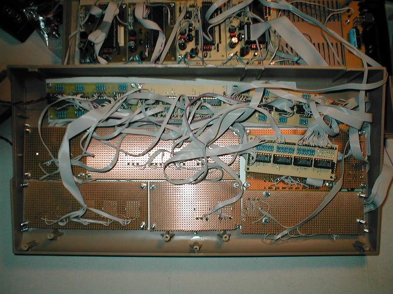

Perfboard for sure!
http://www.midibox.org/midibox_sid_photos/
