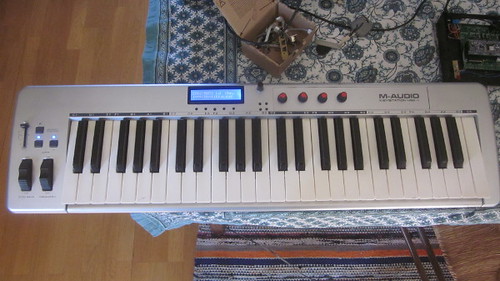

Here’s what the finished unit looks like:
The sample player has no hands-on interface, there’s just 8 banks of mellotron samples available on channel 11. The MBSID however comes with the LCD plus the necessary buttons. The four red knobs don’t do anything yet, but I’ll assign them to filter and LFO tweaking functions later. Note that the knobs are aligned better than the buttons – that’s because the front panel had holes for knobs underneath the “M-AUDIO” panel, probably because the same case is used for some more advanced model with knobs as well.

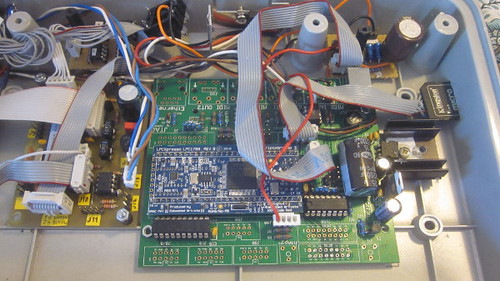

The placement of the MBSID stuff. Probably I could have used the “normal” SID modules as well, but I preferred to use the one I reorganised and etched myself because the connectors fit better. As you can see the “SIDs” are actually two SwinSID nanos. Because the realistic alternative would have been to use two 6581s, I decided to keep the the SwinSIDs to spare myself from having to go buy a 15VDC PSU and from using further heat sinks. The SwinSID sound is not as good, but it’s definetely ok, and even more so as I built this for band rehearsal purposes – of course recording will be performed on an MB6582 with the real stuff in it :slight_smile:

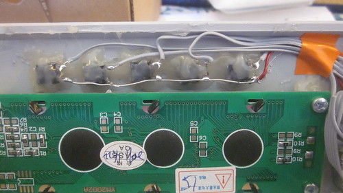

Here’s how I initially tried to put the tactile switch buttons in. There was *very* little space above the keys here in the cover panel, and it turned out that using hot-glued 5mm hex nuts and a strip of veroboard with tactile swtiches on it didn’t work for that reason – it was too much to fit in. So I got rid of the hexes and the veroboard, and hot-glued the tactile switches directly on to the panel:
Even that fit only barely, but it did fit! On the previous picture you can see on the right that the four buttons (up-down-menu-shift) are still on a PCB that’s been hot-glued on. However I had to change that too and just hot-glue the buttons directly on, otherwise there was a key that got stuck.
