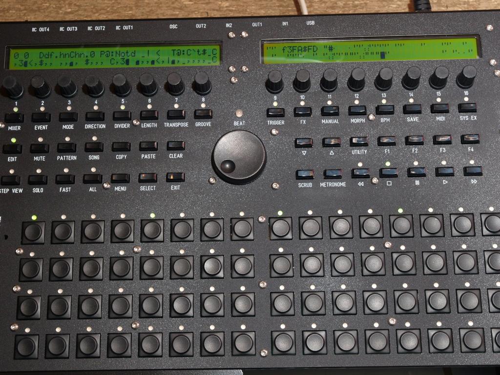

Hi,
I have a rather strange (?) problem with the two displays in my MBSEQ. I tried to exchange the STM32 core with the LPC17 one, and now it seems that the initialization of the two displays goes wrong. I get garbled screens, sometimes just a few letters are wrong, sometimes there is nothing at all on the screens. When I disconnect one of them, the other is fine - this holds for both, the left and the right display. When I switch back to the STM32 core, both displays work as they should. My PSU is beefy enough, it’s a Meanwell RPT-60B. Any ideas?

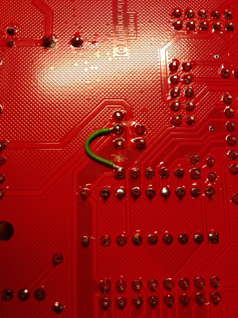

My first guess would be the R33 resistor array… accidentally using a 10k “103” part here instead of the 1k “102” array can cause this.  (both values are in a LPC kit/BOM)
Wrong polarity on the array or an open connection on one pin can also generate the same symptom(s).
Best regards
Tim
Thanks for your input, Tim. But the polarity of R33 is fine, as well as its value. I even measured the individual resistances, all good. This is a v1.0 board that had a wrong trace between the 5V pin of J15_S and the common pin of R33, but that has been fixed with a trace cutter and a short wire between the middle pin and the common pin of R33. It is now exactly as in the schematic.
Edit: added picture of the modification.
