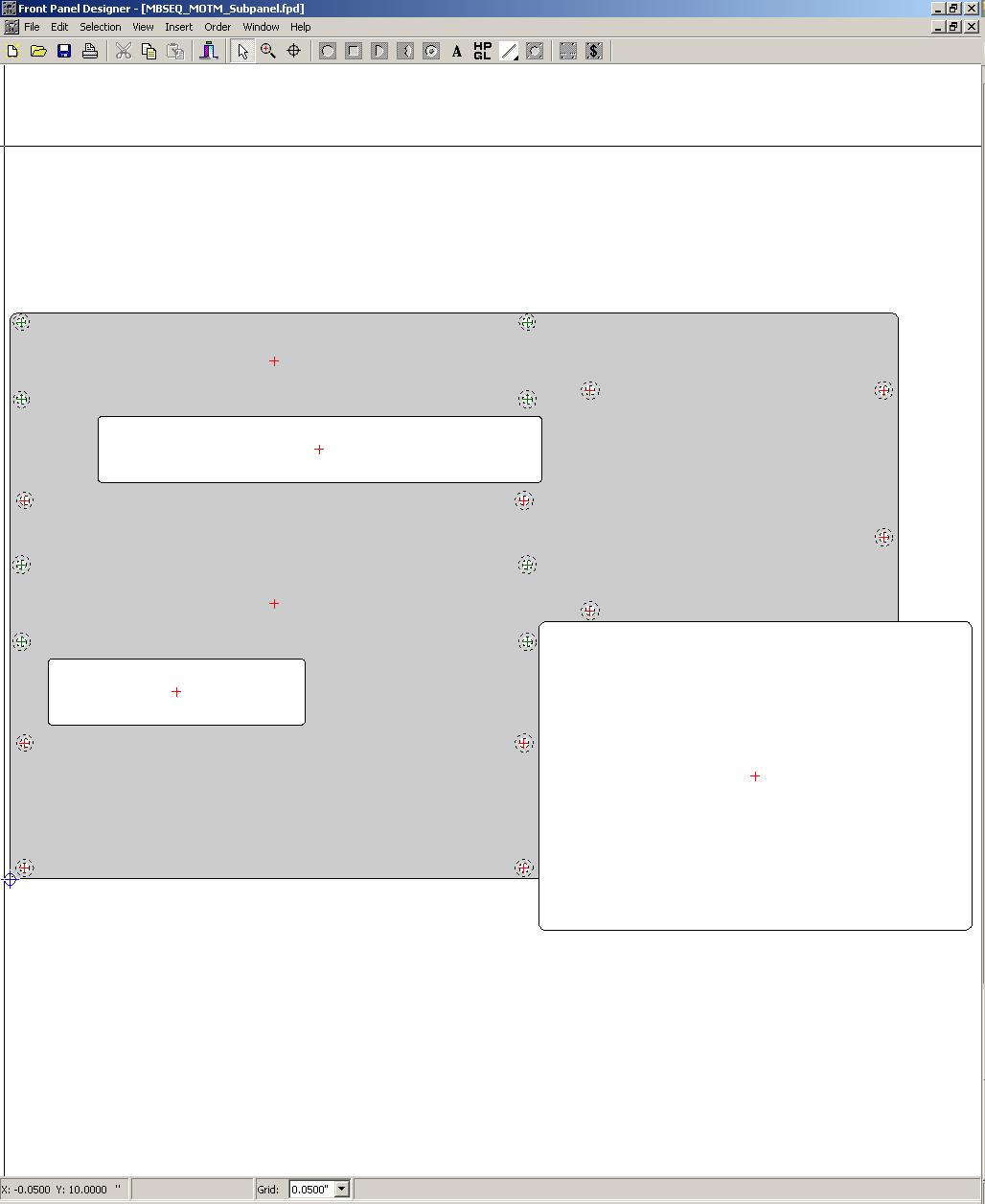

Here is where I’m at with the other half of my MOTM controllers (the other piece being the standard MBCV for connecting to a DAW).  I’m going to use E-Switch 5500 Series switches since I’ve got about half a carton left from the first couple batches of MB808’s and I’ll use standard pad-per-hole to hold the buttons (the encoders will be attached directly to the panel).  I’m going to try using a switched encoder for the Menu button.  Currently this layout is missing a few labels and the neccessary mounting holes for the perfboard, I’m thinking about creating a subpanel in FPE to mount everything to so there are fewer screws on the front panel.
EDIT:  Almost done now, but I’m not ready to order this just yet.  I’m going to wait until I have my MBCV module in hand (which is using some of the same ideas) so that I can see how well some of this will work before spending money on this layout.  I’d also like to find some alternatives for the subpanel.  FPE only works with aluminum and I’d really rather find a place which can work with steel for the subpanel.  This would allow me to try out some ideas to simplify how everything stacks together.  Also, the subpanel alone costs 70$ right now (!!) due to having countersunk screw holes on the reverse side… quite the luxury!   ;)

I’m about halfway finished with creating a sub-panel assembly which will hold the LCD’s, MB modules and pad-per-hole for the buttons.  I’m working on placing cutouts for wiring at the moment… funfun..  Hopefully when I’m done I’ll have a Wilba-esq “flat” sequencer.

The paneldesign is only up to you…
The Default Design based on the Paneldesigner from Shaeffer you can found here:
Default .fpd File (right klick to download)
here the Paneldesigner (only Windows)
Paneldesigner
